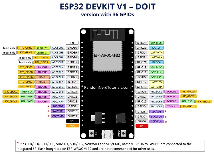

I have this problem. I using DOIT ESP32 Devkit 36 pin version.

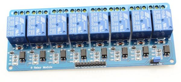

I need using 8-relay module with only set pinMode. Pins between D32-D14 working good but pins D13/D12 not. If I connect it on relay (len on relay channel lighting lower) and arduino sketch in serial monitor write me this message:

Not sure what's with D13, but GPIO12 is a bootstrap pin; the input value it has on startup sets the flash voltage. If you put the wrong level on this pin at bootup, the ESP32 effectively won't boot.

Yes I mean GPIO 12 and 13. Can I want using GPIO 12/13 as OUTPUT with relay or this pins can't be connected?

Yes, you can. Just be sure your relay board does not have a pull-up resistor on its input; that would have the side effect of pulling up GPIO12 on reset, which causes the ESP32 to switch to the wrong flash voltage.

Ok. Thanks for advice. I using this relay module and I think it have pull up rezistor.
