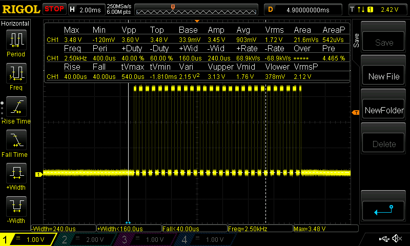

I think setting up a buffer + interrupt could work, I'm not sure if the interrupt latency is deterministic especially if there are other events or interrupts occurring the transmission.
The single item/pulse seems like the right idea, I'm not sure if the carrier wave generator is in sync/phase with the pulse. A scope capture shows the first and the last waves may or may not produce a valid clock edge:
Is there a way to make sure the wave and the pulse are in-phase? The docs refer to the item duration as "ticks" how does one calculate that with respect to the carrier freq?

Re: Using RMT to generate 'n' rising clock edges [faster than gpio twiddling]
Ah, using the carrier wave mode and a single pulse is a much better idea!
The values written to RMT_CARRIER_HIGH_CHn and RMT_CARRIER_LOW_CHn both use this unit, as well as the memory block entries. So if you write a single entry with one "on" pulse, you will want the "on" entry length to be N * (RMT_CARRIER_HIGH_CHn + RMT_CARRIER_LOW_CHn), where N is the number of clock cycles. Followed immediately by a zero-length "off" pulse to terminate the RMT state machine.
If you've programmed the RMT like this and you're still getting the slightly short first & last carrier wave edges shown in the scope trace, can you please post the full code you're using?

Thanks Angus!
I think I see RMT_CARRIER_HIGH_CHn being referenced as RMT.carrier_duty_ch[channel].high.
But I'm not sure if changing that will solve the phase issue. I tried changing the 'items' and placing a 1/4 wave worth of 0 before the pulse of '1', and changing the pulse length and ended up with a fairly regular set of clock edges:
config.tx_config.carrier_duty_percent = 50;
config.tx_config.carrier_freq_hz = 2000;
config.tx_config.carrier_level = 1;
config.clk_div = 255;
{{{ 128, 0, 1024, 1 }}}, // used to be dot
{{{ 32767, 0, 32767, 0 }}}, // SPACE
ABP clock 80Mhz/255 divider = 313725 ticks?
313725 / 2000 freq = 156 counts is a full wave?
-armand
