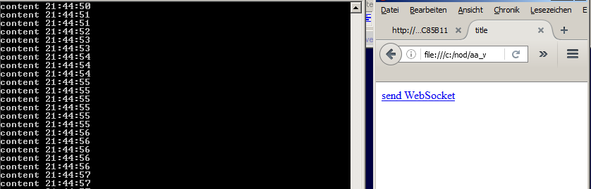

hohi tom,
txs for share - looks promising and i had a try
void ws_server(void *pvParameters){
  struct netconn *conn, *newconn;
  esp_err_t err;
  conn = netconn_new(NETCONN_TCP);
  netconn_bind(conn, NULL, WS_PORT);
  netconn_listen(conn);
  while(netconn_accept(conn, &newconn)==ESP_OK)
     ws_server_netconn_serve(newconn);
   printf("\nhuh!... did not accept\n");
   printf("\ntry to close connection\n");
   netconn_close(conn);
   printf("\ntry to delete connection\n");
   netconn_delete(conn);
void app_main() {
	printf("\ntry to start webserver..\n");
(696) cpu_start: Starting scheduler on APP CPU.
netconn_bind: invalid connnet
conn_listen: invalid connnet
conn_accept: invalid conn
netconn_close: invalid conn
- do we miss something ( two headers ? )
( IP Addr, Protocol[tcp, udp], )

Howdy.
Strange...
Have you defined WS_PORT?
CANopen is irrelevant, that's stuff from the application layer.
I continued working on it, so it looks a little different now. For now I will only handle frames with <126byte, as this is sufficient for my application (which will only use Chrome).
main:
    //Create Websocket Server Task
    xTaskCreate(&ws_server, "ws_server", 2048, NULL, 5, NULL);

Postby rudi ;-) » Mon Jan 16, 2017 9:24 pm
Howdy.
Strange...
If this doesn't work, I can create a small project and upload it, though this is very proprietary and hacky ;)
howdy :mrgreen:
the ws example works itself - nice work!
with your demo perhabs you build a small project for the github examples?
