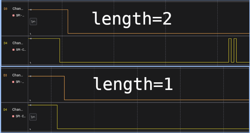

Re: ESP32-S3 freeze in spi_device_transmit() when transaction length is 1 bit (ESP-IDF v5.4.1)
I checked the clock pin with a probe and it never outputs that pulse with length set to 1, but with length set to 2 it works.
Any ideas?
Any ideas?
I'm trying to run libswd-esp32 on esp32-s3 and it freezes at the first SPI transaction, which has length of 1 bit.
Here is a code I used to reproduce it separately, it works on ESP32, but freezes on ESP32-S3.
It only freezes when the transaction length is set to 1.
static spi_device_handle_t ...
