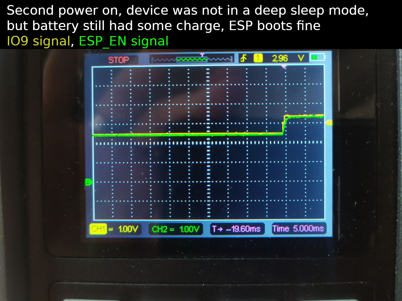

Here is a simplified schematic. IO9 is pulled up with 5.1k. ESP_EN is pulled up with 5.1k + capacitor to add delay for enable signal. IO8 and IO2 may have undefined states at startup in my schematic, as IO2 is used for analog measurements and IO8 for LED control.

I've noticed that this problem happens only when super capacitor is not fully discharged, so maybe at brownout reset it falls into a boot mode somehow. I need to disable this behavior, but how?

Well, at least one issue I can find is that the simple RC circuit you have on EN may not give you a proper reset signal when the voltage on your supercap is gradually increasing/decreasing. The thing is that if the voltage on the ESP32C3 is lower than a given level, its state becomes random and it needs a proper reset (as in: EN taken low and high again) before it's guaranteed to function. The RC circuit is generally used because in most situations, this only happens on powerup (as in: the 3.3V rail suddenly goes from 0V to 3.3V) but in your situation, you may need something more complicated like a voltage monitor.
It's still odd that you get the USB download mode as the bootup mode even with GPIO9 connected high, but given that the bootstrap pins are read on hardware reset, it's not entirely unexpected either.
Note that disabling the brownout detector likely won't help you there, as the ESP32 will still reset (but in a way more unpredictable way, likely by crashing) if the power level goes too low.

Edit: I've made couple measurements of the IO9 and ESP_EN signals, and it looks like the problem happens when power is disconnected.

Sorry, I don't see how a software solution is possible here. First of all, you're already running the ESP32C3 outside of its specs: the datasheet says 3.0-3.6V and according to the scope trace, you're running it on 2.5V, or even 2.0V if the supercap goes empty. That means any guarantee the datasheet implies wrt behaviour goes out of the window. Secondly, the entire issue is that the internal state of the ESP32C3 gets corrupted: even if software would be able to get you out of this problem, you have no guarantee it can properly run in this state.
I'm decently sure at this point you need some hardware modifications. I'd suggest at least a voltage monitor that keeps the ESP32C3 in reset if the voltage is too low, so you know it's always working within specs if not in reset. That does mean that you can't store variables in RTC memory anymore, so you may need some other solution for that as well. If you do want to make use of deep sleep, you need to make sure the software and hardware works in such a way that the ESP32 is guaranteed to go into deep sleep fast after power is gone, and that deep sleep is only exited when the power is back properly. Even then, beware of edge conditions: you may have a power cut again just at the point where the ESP32 comes out of deep sleep, so you need to make sure you have enough power to let it start up, detect there's no power anymore, and go to deep sleep.
