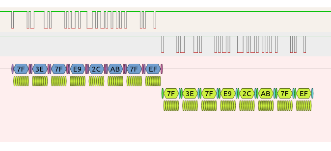

- Sat Jul 04, 2020 7:38 pm
- Forum: General Discussion
- Topic: [SOLVED] UART response too late
- Replies: 9
Re: UART response too late
I found the solution here:
viewtopic.php?t=3751
I had to make struck like above
Result: Thank You very much.
Regards
Regards

- Sat Jul 04, 2020 6:37 pm
- Replies: 9
Oh, ESP_Sprite thank You as well.
- Sat Jul 04, 2020 6:27 pm
- Replies: 9
PeterR, thank You for reply.
Asking for 1 byte:
uint8_t data[1];
while (1)
int len = uart_read_bytes(UART_NUM_2, data, 1, 1);
uart_write_bytes(UART_NUM_2, (const char *)data, len);
Result:
Added FIFO Tresh
uart_intr_config_t uart_intr = {
.rxfifo_full_thresh = 1 ...
Asking for 1 byte:
uint8_t data[1];
while (1)
Result:
Added FIFO Tresh
- Sat Jul 04, 2020 5:08 am
- Replies: 9
Thank you very much PeterR for your answer.
The upper signal is RX the lower TX as You assumed.
I can't change the baudrate, data is read from the connected device and sent alternately.
Could you please explain how to reduce latency?
