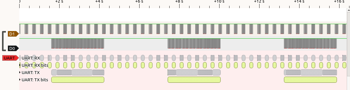

I have problem with UART response. I am sending a frame of bytes to RX and send them back to TX. Delay between end of RX transmission end start of TX is 150 ms. I need to shorten it to 40 ms.
What am I doing wrong?

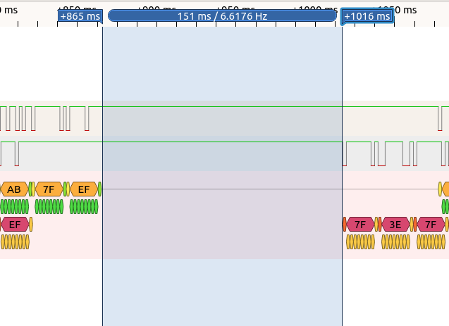

(1) You use 450Hz baud rate & a buffer of 8 bytes. Thats 140 mS + start/stop/parity.
If you must use 450Hz baud then you might reduce latency (end receiver latency) by reading one byte at a time and relay (but only by tx size -1 + some driver latency).
(2) I don't get your trace.
You don't show signal labels.
If I were to assume that the top signals are the RX and bottom TX then why is TX data different to RX?
We can explain the 150mS gap between RX and TX as (1) above.
The bottom line will be that the last TX byte will only leave the gate at 140mS+ (after being received) unless; you increase the baud rate &/or develop mystical abilities to predict the last byes within the esp ;)
EDIT: 2400 should do it, 9600 would rock & 19200 would beat your 40mS requirement into the dust.
PS
See now that data is supplied by the RX, so even more confussed why TX is different
& I also believe that IDF CAN should be fixed.

The upper signal is RX the lower TX as You assumed.
I can't change the baudrate, data is read from the connected device and sent alternately.

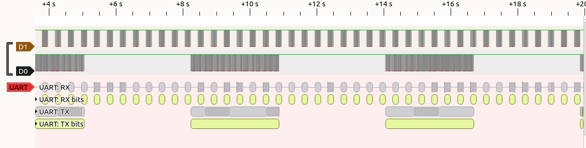

Result:
Added FIFO Tresh
uart_intr_config_t uart_intr = {
    .rxfifo_full_thresh = 1};
  // //  .rx_timeout_thresh = 22};
  uart_intr_config(UART_NUM_2, &uart_intr);
  uart_enable_rx_intr(UART_NUM_2);
Result:
Timeout added:
      .rxfifo_full_thresh = 1,
Result:
Am I doing something wrong?

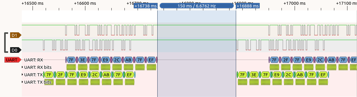

Probably I found the solution.
Now testing.
gibzwein
Posts: 11
Joined: Fri Jul 03, 2020 3:19 am
Re: UART response too late
Postby gibzwein » Sat Jul 04, 2020 7:38 pm
I found the solution here:
viewtopic.php?t=3751
I had to make struck like above
Result:
Thank You very much.

Without looking at your code - still looks like you can do better.
You're trace seems to show that you only output the first byte after all 8 bytes have been achieved. You could output the first byte after the first byte has been received! Maybe this is the FIFO issue related by Sprite.
If you are happy then np. Don't optimise what you don't need to, just checking you see the approach.
