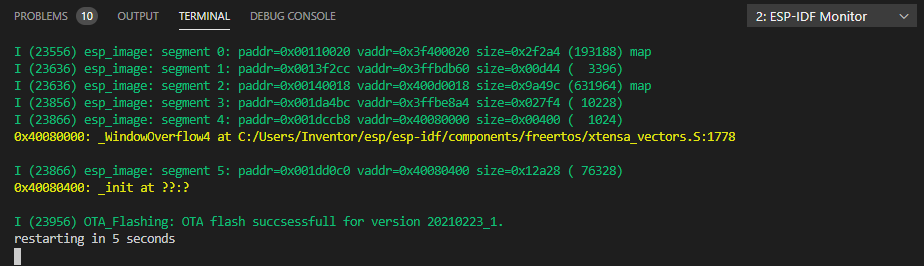

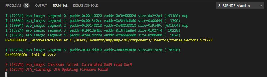

- Mon Mar 15, 2021 7:11 pm
- Forum: ESP-IDF
- Topic: [SOLVED] OTA Different behavior on different boards !!
- Replies: 2
Re: OTA Different behavior on different boards !!
For those who may face the same issue. It is a battery issue, My battery was not charged good and it seems during the OTA the Wifi requires more peak current hence the battery lake to supply the required current, and hence the process fails.
Charging the Battery solved the Problem.
- Sun Mar 14, 2021 10:29 pm
- Forum: ESP-IDF
- Replies: 2
Hi Everyone, Can anyone tell me what could be the cause that makes one board (always) successful to update the firmware through OTA
while the other board but also uses WROOM32 chip (always) fail with the same code !!

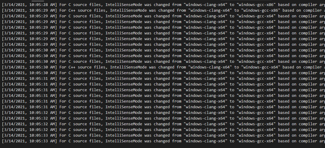

- Sun Mar 14, 2021 9:08 am
- Forum: IDEs for ESP-IDF
- Topic: New VSC Updates Stops Project build
- Replies: 3
Re: New VSC Updates Stops Project build
I noticed also that my C/C++ Compiler has been changed !!
How I can change the compiler back to the old clang-x64 ?
