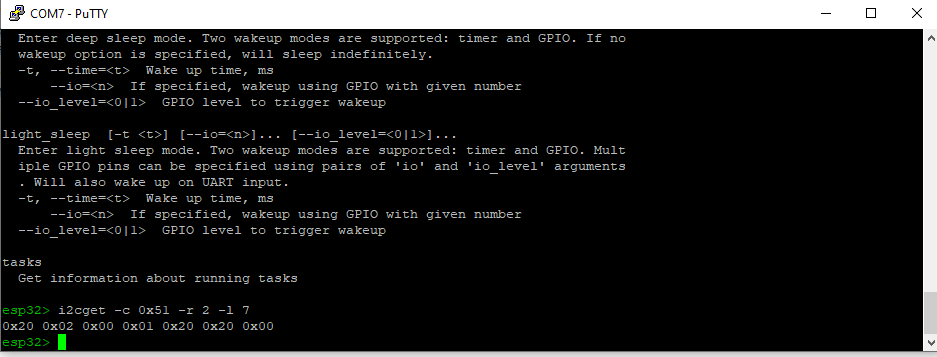

using the ESP i2c tool to check the RTC I get a correct time reading (Reading 7 bytes-> starting from seconds up to years). Then I know that there are now Hardware connection issues.

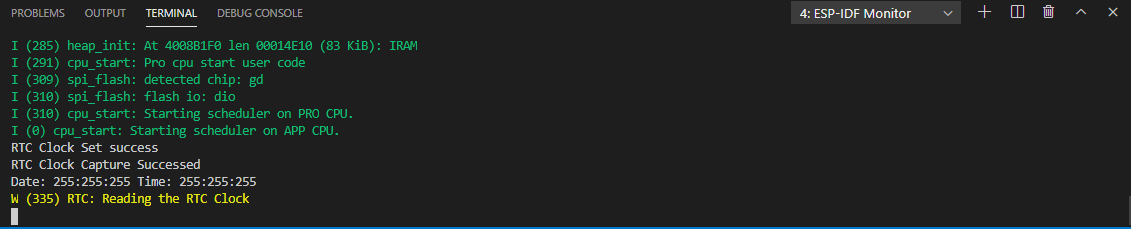

now when I try to read the RTC chip by the code, I don't get the correct results !! My RTC Read routine is
  uint8_t Data_Reg[7] ;
  uint8_t Data_Reg_Size = 7;
  CMD_RTX_Get = i2c_cmd_link_create();
  i2c_master_start(CMD_RTX_Get);
  i2c_master_write_byte(CMD_RTX_Get, (RTC_Add<<1) | Write_Bit, Want_Ack);
  i2c_master_write_byte(CMD_RTX_Get, VL_secondsReg, Want_Ack);
  i2c_master_write_byte(CMD_RTX_Get, (RTC_Add<<1) | Read_Bit, Want_Ack);
  if(Data_Reg_Size > 1)
    i2c_master_read(CMD_RTX_Get, Data_Reg, Data_Reg_Size - 1, ACK_VAL);
  i2c_master_read_byte(CMD_RTX_Get, Data_Reg + Data_Reg_Size - 1, NACK_VAL);
  i2c_master_stop(CMD_RTX_Get);
  esp_err_t ret = i2c_master_cmd_begin(I2C_NUM_0, CMD_RTX_Get, 1000 / portTICK_RATE_MS);
  if(ret == ESP_OK)
    printf("RTC Clock Capture Successed\n");
    printf("Date: %02d:%02d:%02d Time: %d:%d:%d\n", Data_Reg[6], Data_Reg[5], Data_Reg[3],
                                                   Data_Reg[2], Data_Reg[1], Data_Reg[0]);
  else
    printf("RTC Clock Captured Failed\n");
  i2c_cmd_link_delete(CMD_RTX_Get);
But the Results comes out like this:
Kindly, inform me about what I'm missing.
