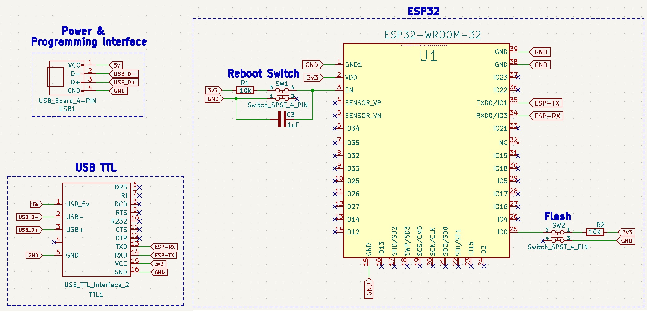

Re: Minimum ESP32 circuit required for runtime
Hi @ESP_Sprite, thank you for your help. So, how is the below now?
Many thanks
Alan
Many thanks
Alan

Re: Help to build a minimal EPS32 PCB
Hi ESP_Sprite,
Again, thank you for your help. I really like the idea of off-site buttons, I never even through of that. I think it will be best to keep the Reboot button on the board as I can see times it won't be as simple to power cycle the device, but having the Flash/Program button off-site on ...
Hi ESP_Sprite,
Do you think my two schematics are ok?
I know it is the Chinese New Year, but desperate to get a test mock-up PCB designed so I can test out my designs.
Many thanks
Alan
Many thanks
Alan
C7 and C3 are in parallel with eachother, so you can remove one of them. Suggest to make whichever one remains 1uF instead as is advised in the datasheet. Also, in my experience, if you don't use the exact transistor as on the devkit and you have issues with the auto-reset circuit, it can help to ...
