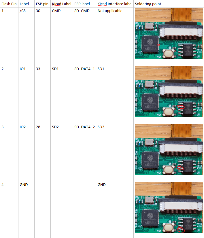

You may remember I was having issues with the designer. I finally got my money back but I want to use the design as the basis of version 2, if possible. The first design didn't have flash, so, I guess I have a couple of options.
a) add external flash
b) use an ESP chip that includes flash ...

Re: New ESP32 Board Bootloader
So, should I be using the same clock or the separate clock for the flash? Does it matter?
And does anyone know what /CS and /HOLD etc is?
Ah!
So, I think I have the pins correct but the wrong labels on them. I'll double check that shortly.
As for the clk pin, according to the hardware guidelines, psram and flash can share the same clock, though there is a separate clock on the esp32. At least, that's my understanding.
Also, can ...
Also, can ...
Here is the table:
I have marked, in red circles, where I think the soldering should be done but I'd be grateful for any thoughts anyone has on what I have said and shown.
Thanks.
Thanks.
I'm waiting for a new design from the designer, who has admitted that he missed the flash chip of the first design. I'm still keen to have a go at fixing the original board and I have more information now about the flash chip to use. I've also done a bit of research and I believe that I now ...
