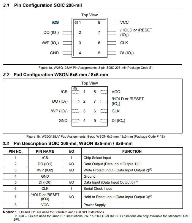

I'm waiting for a new design from the designer, who has admitted that he missed the flash chip of the first design. I'm still keen to have a go at fixing the original board and I have more information now about the flash chip to use. I've also done a bit of research and I believe that I now know how to solder in the flash chip but I would like to run it past you guys for verification.
The flash chip is W25Q128JVSIM TR and has the following pin config:
flash chip pin config.png (84.93 KiB) Viewed 6688 times

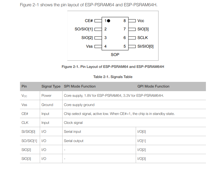

It shares a lot of the pins with the PSRAM and, according to the ESP32 hardware design, can be multiplexed with all of the pins, with the exception of the CS pin.
PSRAM chip pin config.png (47.21 KiB) Viewed 6688 times

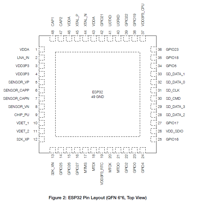

Below is the ESP32 DOWDQ6 pin config. If understand the documentation correctly, pin 30, labelled SD_CMD is what is used to connect to the CS pin on the flash.

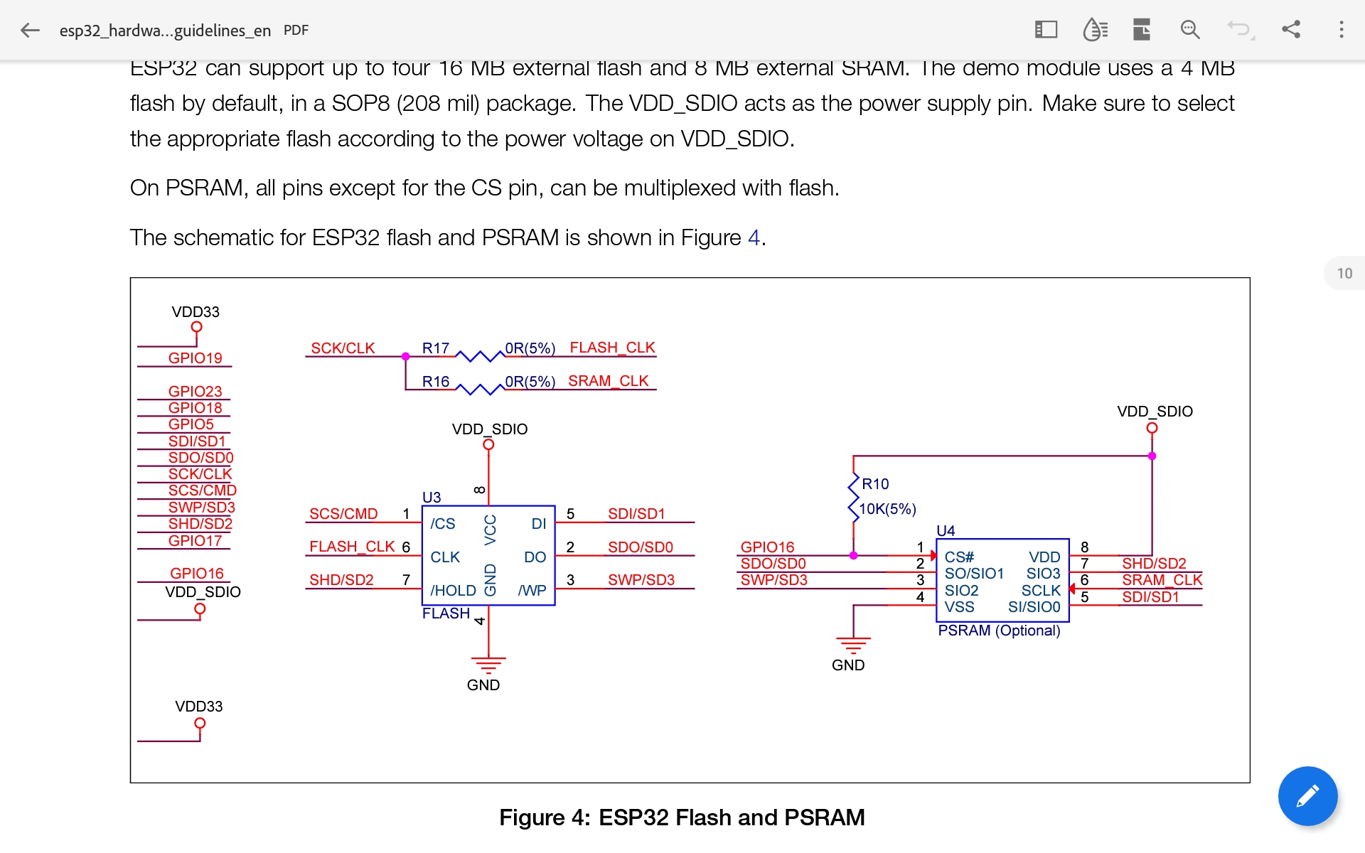

You are on the right track, unfortunately SD# does not map directly to IO#, you should use the SPI labels. Check the esp32-wrover schematic in the datasheet. I don't know if sharing a clk pin is officially supported.

As for the clk pin, according to the hardware guidelines, psram and flash can share the same clock, though there is a separate clock on the esp32. At least, that's my understanding.
Also, can you tell me what the difference is between /CS and CS#, please? I get that CS# is inverted but not what /CS is.
