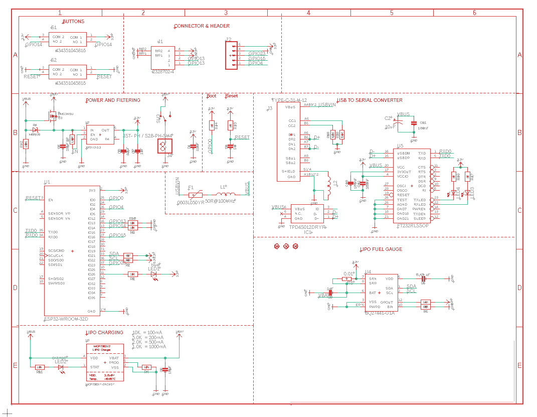

I recently had a prototype made that used a FT232RLSSOP and UMH3N for Usb to serial and programming.
The circuit looks like this:
I thought this would be enough to automatically program the ESP32 for the arduino IDE, but I'm probably missing something.
I get ...

custom ESP32 board produces "garbage" on serial
I'm having some trouble with a ESP32 based custom board I had created recently. I had 5 prototypes created, 3 of them work fine, but 2 of them only spit out garbage on the serial output, like this:
I can't get these boards into programming mode, not even when I manually pull ...

Not able to program custom ESP32 board with FT232R USB to UART chip
I recently had someone design a board for me that uses a ESP32-WROOM-32D and a FT232R USB to UART chip.
The idea was to make the board in such a way that it would be programmable using the EspTool.
Unfortunately, I'm unable to program the board. The only way I can program the board is by manually ...
