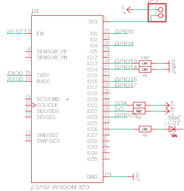

I recently had a prototype made that used a FT232RLSSOP and UMH3N for Usb to serial and programming.
The circuit looks like this:
The attachment SHOT1.PNG is no longer available
I thought this would be enough to automatically program the ESP32 for the arduino IDE, but I'm probably missing something.
I get the following error:
esptool.py v2.6
Serial port COM8
I also have a reset button on the board which just connects EN to GND. When I press that button (a few times) when I see "Connecting........_____", the programming actually starts and works.
Any idea where I'm going wrong?
Posts: 10619
Re: ESP32 programming circuit not going into program mode automatically with UMH3N
Postby Sprite » Fri Aug 13, 2021 2:50 am
The 1K resistor pullup for EN seems a bit too strong to me... I'd replace that with an 10K, perhaps that helps.
