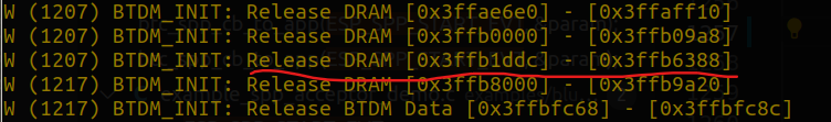

Re: Memory consumption of bluetooth is enormous
Classic Bluetooth controller memory can be freed, but this means you can't use classic Bluetooth mode.

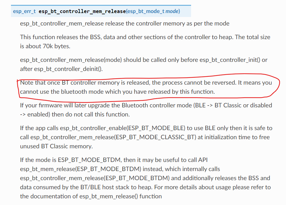

屏幕截图 2021-06-22 114320.png (140.51 KiB) Viewed 9665 times
