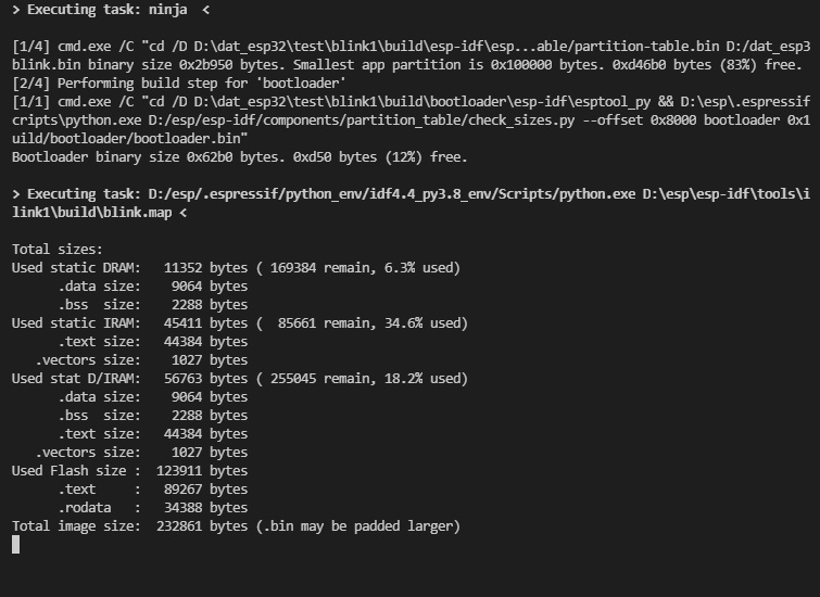

- Tue Feb 01, 2022 4:03 am
- Forum: IDEs for ESP-IDF
- Topic: VSCode ESP-IDF Flash and Ram Size
- Replies: 4
Re: VSCode ESP-IDF Flash and Ram Size
Here's what the Build command in VSCode ESP-IDF extension v1.3
reports using ESP-IDF v4.4
