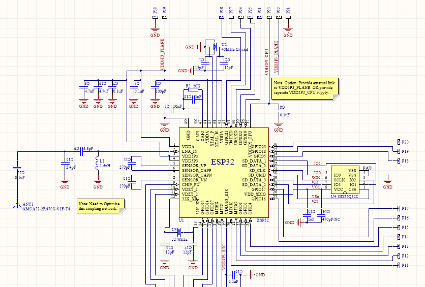

Re: ota checksum failed
Problem found - it was our power supply - not handling the peak currents - thanks for your help
So it looks like if the tcp data is correct because I did an on the fly md5 hash (as I receive the packets) and it passes - but fails the hash on the flash partition.
Hardware configuration attached - its our own module.

ota checksum failed
Hi Espressif ,
This looks like a hardware problem on our module - can someone help me as to the reason why this may happen. After doing an OTA update of the esp32 I get :
E (148645) esp_image: checksum failed. Calculated 0x8d read 0xff
The bootloader is updating through serial fine - so Im not ...
