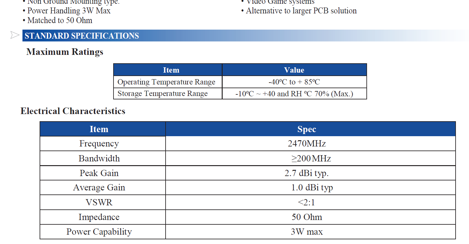

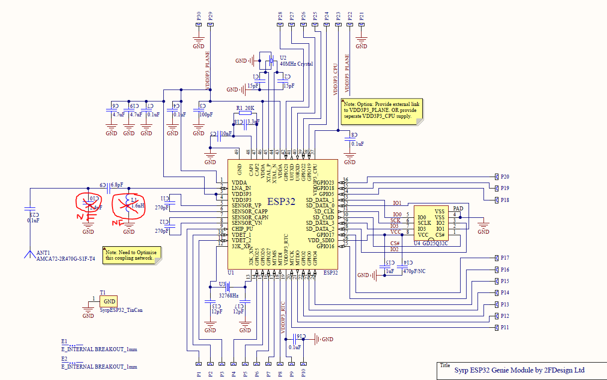

Our hardware is essentially the same except for these few differences:
1 - we are using a chip antennae (attached specs)
2 - different crystal and load caps (the frequency is +0.8kHz offset from 40MHz)
3 - The PI matching network is different as the antenna we are using is different. We have matched the antenna manually resulting in the match network you see in the schematic.
By the way the RF power output from the module is comparable or better than the esp WRover kit.
Any help /ideas would be highly appreciated
Regards
Imtiaz

Postby ESP_igrr » Wed Nov 22, 2017 4:57 am
For RF matching issues, it is best to contact Espressif via sales@espressif.com. Testing and optimization of customer hardware can be arranged (you will need to send us the board). Things like this a fairly hard to troubleshoot on the forum, plus the three ESP_ engineers tagged in the first post are definitely not the ones to seek advice from on RF related issues.
