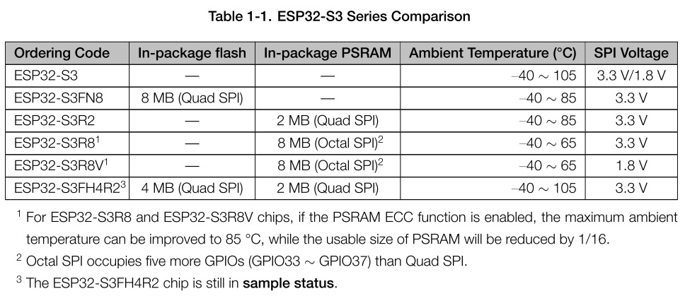

Re: ESP32-S3 with large FLASH resets before second-stage bootloader
Ok. But GPIO 33 to 37 should be free, right ? Im my case they are not.No, you do not. For instance, our ESP32-S3-WROOM-1-N8R8 module has octal PSRAM but quad flash.
Hello !
I'm using ESP32-S3R8V.
Datasheet says: It says that internal PSRAM is on octal SPI.
Does it mean that I HAVE TO use an octal SPI link for my external flash also ?
Do you know a list of compatible flash?Another thing is that your flash simply may not be compatible with the mode you selected (although from the datasheet, it should support DIO...) Could you try to select any of the other flash SPI modes? (for instance, QIO)
