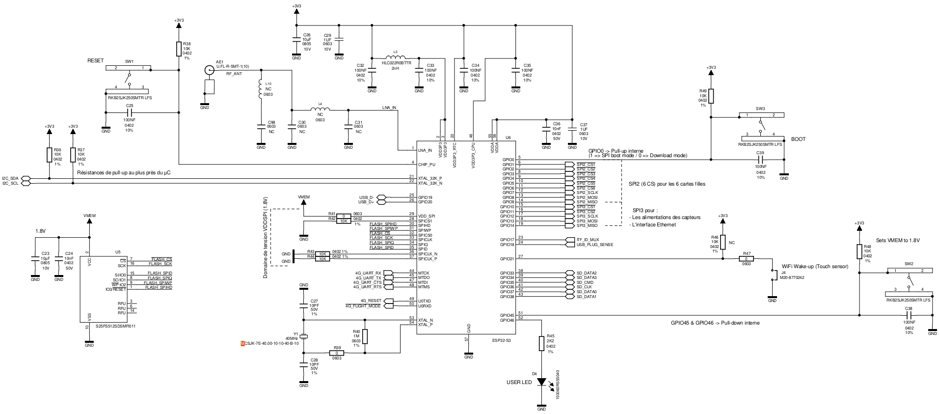

I have issues with my custom board. The FLASH is 64MB (S25FS512S) and connected as follow:
Capture d’écran du 2022-12-05 18-09-23.png (196.83 KiB) Viewed 11106 times

This goes on forever. It looks like the watchdog is failing but the entry point is not even reached.

Any idea what I'm missing?
Communication with ESP32-S3 and with FLASH seems ok...
I spent two days on this and I'm out of things t try.

You're using the internal USB-serial-JTAG controller, right? Could be that you're missing some info that the chip spits out just before it resets in that case. It may make sense to see if you can read what's on the U0TxD serial pin, see if that hints at anything.

GPIO45 level on reboot? (page 23 and table 2-10)
I dont know much about hardware, but maybe C38 is too small? You could try to burn efuse to set VDD_SPI and to see if its flash voltage.

Another thing is that your flash simply may not be compatible with the mode you selected (although from the datasheet, it should support DIO...) Could you try to select any of the other flash SPI modes? (for instance, QIO)

GPIO45 is hi on startup. Well actually it's 2.45V because of internal pull-down. Maybe I should decrease R48 (external pull-up).
What is strange is that VDD_SPI is 1.9V instead of 1.8V. It should be working anyway, but it's not normal, right?
P.S.: I tried replacing R48 with a wire, it does not change VDD_SPI.
Julien1138
Posts: 12
Joined: Mon Dec 05, 2022 4:38 pm
Re: ESP32-S3 with large FLASH resets before second-stage bootloader
Postby Julien1138 » Wed Dec 07, 2022 8:57 am
Flashing error changed! I don't think I change anything on my part...
esptool.py v4.4
Serial port /dev/ttyACM0
Connecting...
Chip is ESP32-S3 (revision v0.1)
Features: WiFi, BLE
Crystal is 40MHz
MAC: 7c:df:a1:e0:ed:ec
Changing baud rate to 460800
Changed.
Enabling default SPI flash mode...
Configuring flash size...
Flash will be erased from 0x00000000 to 0x00005fff...
Flash will be erased from 0x00010000 to 0x00041fff...
Erasing flash...
Took 1.74s to erase flash block
Wrote 22528 bytes at 0x00000000 in 0.5 seconds (330.7 kbit/s)...
Hash of data verified.
Erasing flash...
Took 2.06s to erase flash block
Writing at 0x00040000... (97 %)
A fatal error occurred: Failed to write to target Flash after seq 192 (result was 01053237: Requested resource not found)
Maybe this will ring a bell?

Postby Julien1138 » Thu Dec 08, 2022 12:47 pm
Hello !
I'm using ESP32-S3R8V.
Datasheet says:
ESP32-S3 Series Comparison.jpg (141.57 KiB) Viewed 10895 times
It says that internal PSRAM is on octal SPI.
Does it mean that I HAVE TO use an octal SPI link for my external flash also ?
