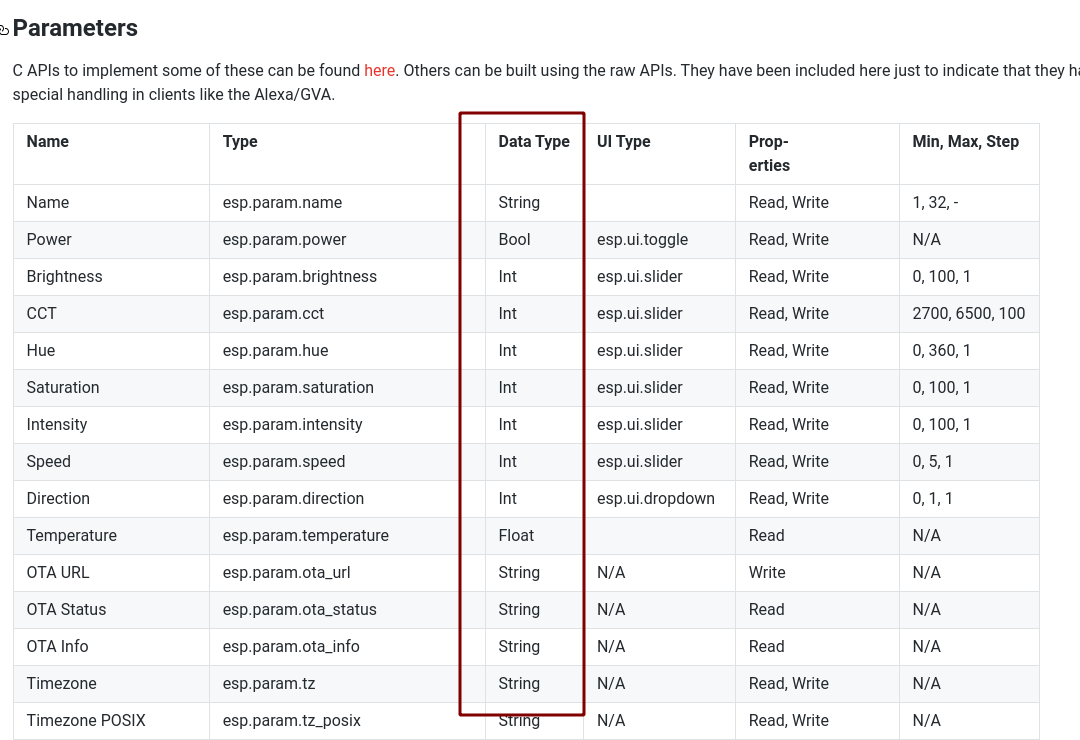

Re: Can the data type of Parameters be "File"?
Hi ESP_Piyush,
Thank you for your answer, it has been very helpful to me.
Hi ESP_Piyush,
Thank you for your answer.
Where can I see Rainmaker's introduction to "Data Type", especially the difference between "String" and "Array"?
I saw on the official website that the data type of Parameters can only be "String", "Bool", and other basic types. Can I send "File"?
