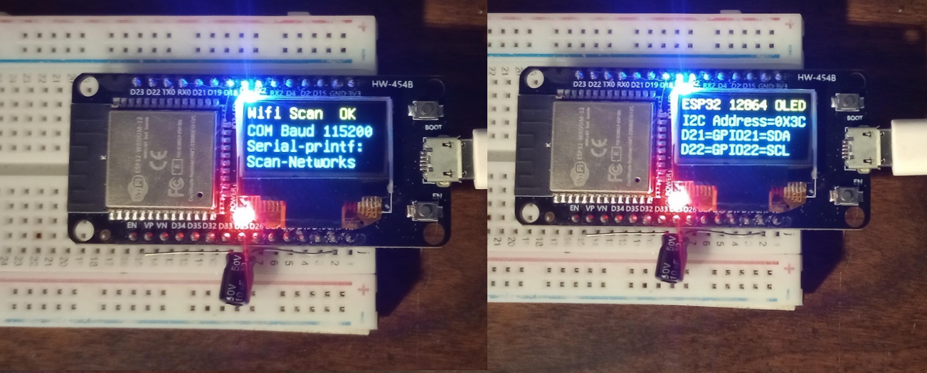

Edit: With the UART bridge I can ampy put, but cannot otherwise. This suggests a power issue even though the capacitor from EN to GND is for that. I am still unable to flash firmware.
When I open Thonny, it says device busy. If I run esptool in terminal I get an invalid head of packet error. If I ...

Serial monitor:
configsip: 0, SPIWP:0xee
mode:DIO, clock div:2
load:0x3fff0018,len:4
load:0x3fff001c,len:5148
load:0x40078000,len:12880
load:0x40080400,len:3484
entry ...

It wasn't the breadboard, either, and the capacitor only solved part of the problem:

Okay, so what I did was place that 10mf cap, not directly from EN to GND, but to the negative rail of the breadboard. From their site, I chose an earlier version of the .bin for ESP32. Then in Thonny, I chose MicroPython(generic) instead of MicroPython(ESP32).
The ...

This is what makes me think it isn't:

Nope. Just blank. Not even garbled serial data.If you connect to the port in miniterm (115200 baud), then reset the board, do you see a signon message? (e.g. ' ets Jul 29 2019 12:21:46') If not, yeah, your board likely is broken.

Faulty board?
I purchased the ESP32 Development Board WiFi & Bluetooth Dual Cores Wireless Module CH340 Driver Support Integrated PCB Antenna with 0.96" OLED Display for Arduino/Micropython, USB Interface 34GPIOs
which is now listed as: 5PCS D1 Mini ESP32 ESP-WROOM-32 WLAN WiFi + Bluetooth IoT Development Board ...
