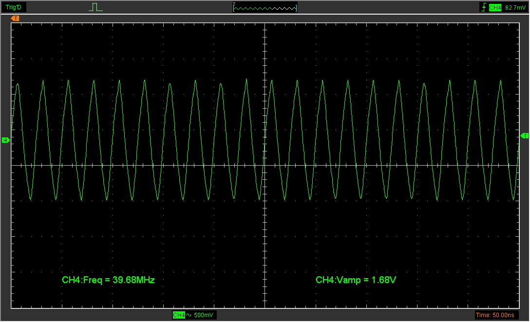

rudi, krzychb thanks for your help, I use this pulse signal to test osciloscope bandwidth.

could I to generate 40Mhz pulse on esp32 GPIO
I tried from those codes on Google but seem they doesn't work! Is the esp32 can do that?
