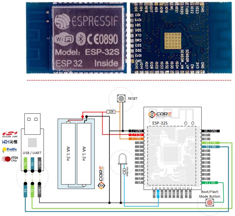

Solved. I ran some integrity test on all the pins, and there's an internal short between two of them. I found a fresh, never-used module and it flashes OK.

Oh, I didn't realize the CDN wasn't letting you through. I've attached the circuit diagram to this post (so it's uploaded to the Espressif server). You should now be able to see it.

Do you mean the image of the circuit? If it's not displaying inline, it's available here.Where is the image?

How to flash a WROOM module using an FTDI programmer?
I've been struggling to understand why my flashing circuit isn't working. It's a copy of the image below, but without the LED, and using a real 3.3V power supply.
https://www.14core.com/wp-content/uploads/2017/04/ESP32-Flash-USB-UART-Wiring-Guide-diagram.jpg
I know the module works, because I ...
