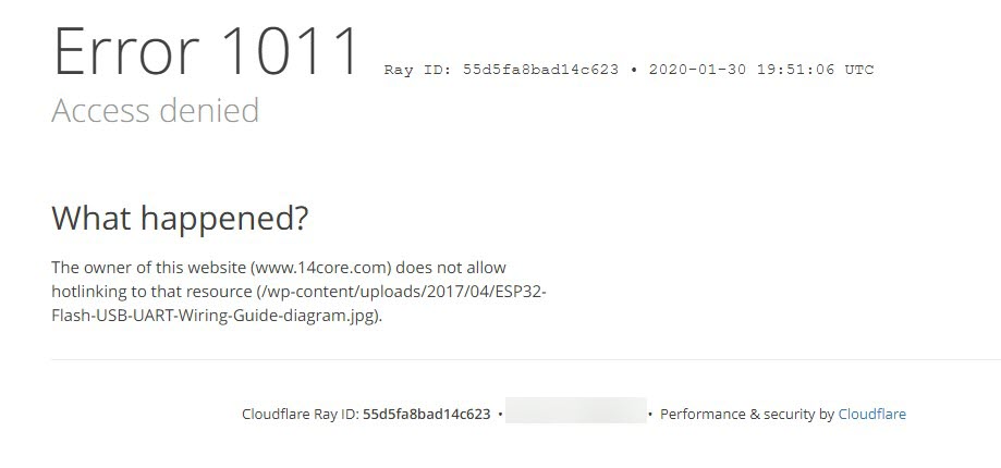

mikemoy
Posts: 686
Re: How to flash a WROOM module using an FTDI programmer?
Postby mikemoy » Thu Jan 30, 2020 7:52 pm
Same thing here is the screen shot. You can just drag your .jpg file into the post, then click place inline. That works for me.
Annotation 2020-01-30 135128.jpg (36.7 KiB) Viewed 28033 times
