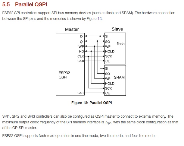

Does this mean GPIO9 and GPIO10 can be used instead of GPIO16 and GPIO17? Also, are the pins physically wired or can the GPIO matrix be used to switch out the pin functions? Thanks!

No, sorry. The flash and psram have slightly different timing requirements, and the intrinsics of the cache mechanism makes it impossible to cater to both using one clock line. I was surprised by that myself as well and suggested a few workarounds to the digital team, but seems they already thought of all of them and the only way to make it work is by using a separate clock line.

then sry - this info in the tech referenz manual is then wrong and a bug - please add me to the bug bounty for it :|
Side 79
ivan tweets last hours the same and i think then the referenze manual need an update asap and very fast.
now the pSRAM puzzle becomes more face
D0WD:
we need 1.8V, S3:S0 share pins, CLK and CS is difference to the Flash, pSRAM use IO16 for CS and IO17 for CLK

and now we know the CS( IO16) and CLK (IO17) pin in Wrover.
