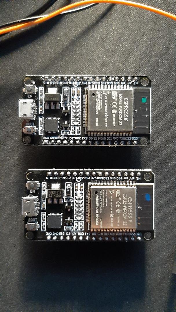

Hi guys,
recently I bought a couple of ESP32 Dev boards:
The upper one has already power indication diod soldered off. But for some reason in deep sleep the power consumption is 9.7mA (resp. 11.2mA with the diod on).
I wanted to use a 3.7V 700mAh LiPo battery but it's drained in 3 days. Battery is connected using VIN, GND pins. The test code is just this:

Postby Sprite » Wed Sep 18, 2019 3:14 am
If any, replace the AMS1117 LDO, they're notoriously inefficient.

Thanks for the answer. I have a couple of HT7333s at home, so I'll try that!

Postby Sprite » Thu Sep 19, 2019 3:57 am
You can try, but do note that those LDOs are limited to 250mA. The ESP32 needs a minimum of 500mA on WiFi initialization, otherwise it'll brown out. (If you want to test it anyway: a hacky solution would be to put two HT7333 chips in parallel.)
