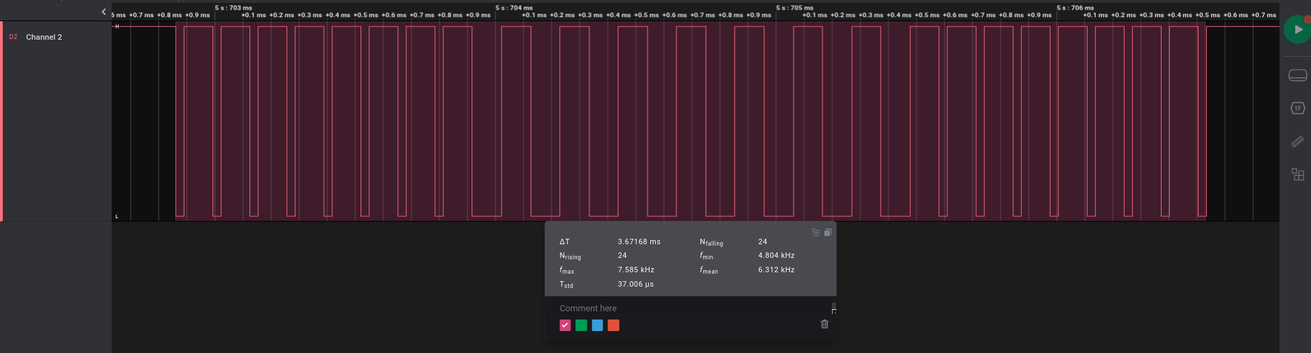

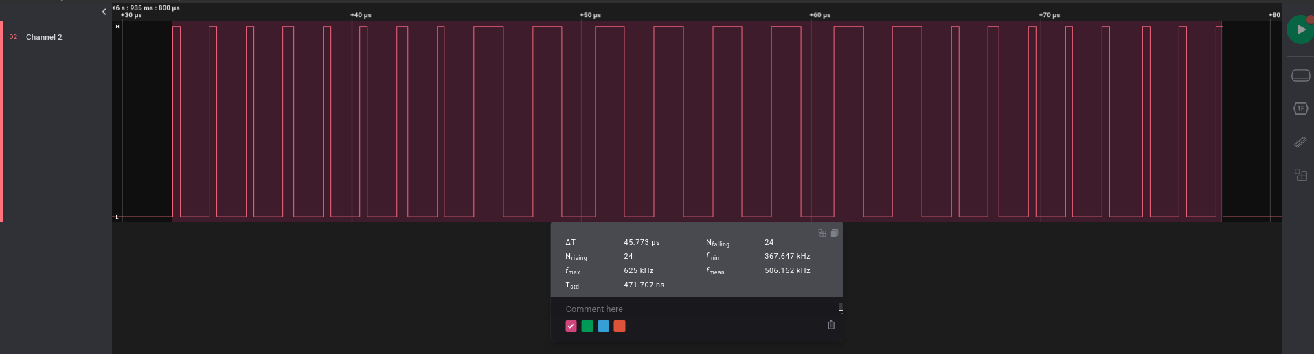

I've been working with ESP32-CAM implementing the WS2812 with RMT. On the first deployment, the WS2812 works fine, but if I enable the PSRAM (required for accessing cam) the IO behaviour is uncertain.
I'm using IO33 as my signal pin to WS2812. While probing that IO the behaviour is shown.
Before enabling PSRAM
After enabling PSRAM
My CPU core is running at 240MHz and the flash size is 4MB
What am I missing? Any additional configurations required to work with PSRAM?

Nothing particularily wrong there. Can you post your entire project, perhaps? It's odd that the two waveforms seem to be the exact inverse of eachother.

ESP_Sprite - Thanks for looking into the file I provided. I managed to get it working with PSRAM enabled after changing ws2812_control_init().
rmt_config_t config = RMT_DEFAULT_CONFIG_TX(LED_RMT_TX_GPIO, LED_RMT_TX_CHANNEL);
config.clk_div = 2;
ESP_ERROR_CHECK(rmt_config(&config));
ESP_ERROR_CHECK(rmt_driver_install(config.channel, 0, 0));
