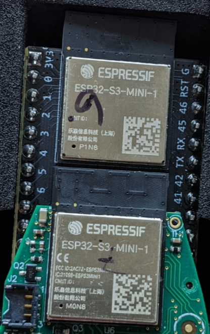

We have a custom design using ESP32-S3-Mini-1 that we flash using ESP IDF tools via ESP Prog/UART
Flashing goes through just fine but on boot all we get after reset is "Invalid Header" scrolling through on UART.
The same programming script and binaries, when flashed to an ESP32-S3-DEVKITM boots and runs fine.
If we look at UART stream of a blank board we get "Invalid header" messages right out of the box.
Trying to figure out what's different between the two or what are we missing.
All strapping pins are brought to test points and are floating/using default IPD/IPU
Dev kit has ESP32-S3-Mini-1 datecode P1N8
Custom HW has ESP32-S3-Mini-1 datecode M0N8
Flashing script, efuses readout of dev board and our board and UART output attached below

There's Mini-1 variants with and without PSRAM. Any chance that is the difference? If so, do you have IO26 connected to anything?
Re: ESP32-S3-Mini-1 custom hardware- failure to boot/ invalid header message
Interesting, we have nothing connected to pin26/GPIO26. For now we got it working by removing encryption, but still not clear why the same scripts worked on dev board. Would the presence/absence of PSRAM do that? The exact module PN on our board is ESP32-S3-MINI-1-N8, but I have no way of knowing what's on Dev board.
Can you tell from this picture or is there another way?
- MOdules.PNG (651.89 KiB) Viewed 6354 times
From what I can decypher, both are PSRAM-less modules according to the packaging information sheet we have (see the xxN8 on the bottom of the module; that would be xxN8Rx for a psram-containing module). The other difference is that the one on the black board is a preproduction model (P1) while the other is a mass-production unit, but I don't know if there are actual physical differences between those.

I would suggest to decode boot in this log:
Vs
Usually it's strapping pin.
rst:0x1 (POWERON),boot:0x8
rst:0x1 (POWERON),boot:0x2b
