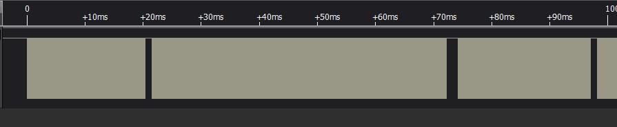

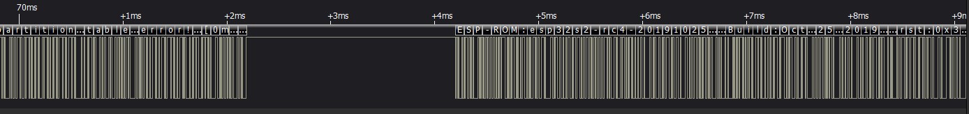

I have a new board that is the first in a line of products that plan to use the esp32s2. I am having problems getting the board up and running. For several weeks I have been using the Waveshare development board using the pico board footprint. I have been developing code using Eclipse and the 5.0 version of the SDK. I now have my professionally assembled 4 layer boards up and "running". The 3.3v power supply looks clean as a whistle. The 40mHz oscillator comes up fine. JTAG and USB have issues but today I am focusing onloading code in using the UART0 RX and TX. I have verified that my code works by loading into the Waveshare board using UART0. I then try loading the same code from the same eclipse session. When flashing code into the two systems Eclipse IDE console looks identical. However pushing the reset button on the two targets, while monitoring the UART traffic, produces very different results. My s2 board reports a lack of partition table. Then 75mSec later the it reboots "rst:0x3 (RTC_SW_SYS_RST)". It appears that the ULP is resetting the main core. I have used the esptool.py erase_flash command and it reports "Chip erase completed successfully".
I have attached a text file showing the flashing console output and booting reports. I also attached logic analyzer outputs of the boot sequence.

- BadFlashAndBoot_130_mSec_image.JPG (18.14 KiB) Viewed 3590 times
- ULP_reset_at_74_mSec.JPG (55.43 KiB) Viewed 3590 times

Your issue likely is pin 36, SPID. You have routed this to a mosfet, probably thinking it's part of a general-purpose SPI controller. It's not. It's part of the interface to the (internal, in the chip you chose) flash. See the datasheet, specifically the note on page 14. This makes A. the thing connected to the mosfet not controllable (as you can't control the SPID GPIO without your program crashing) and B. loads this pin down so you can't have high-speed signals there anymore, which makes lowering the flash speed sortta-kinda work.
Note that SPI can be routed via the GPIO matrix, so connecting the mosfet to any (otherwise not used) GPIO instead should fix this and make the mosfet controllable by a SPI peripheral.
