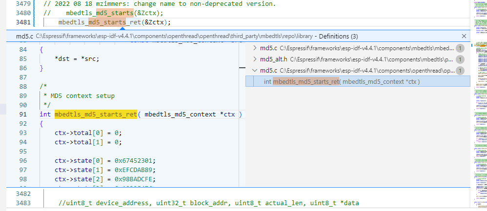

Hi all -
I'm porting a program to the ESP32. I just enabled the portion of code that uses md5 (it supplies its own files for this) and now I can't link. When I try to use the files in my project folder, this code passage:
    mbedtls_md5_init(&Zctx);
    mbedtls_md5_starts(&Zctx);
results in this error:
	C:/Espressif/frameworks/esp-idf-v4.4.1/components/mbedtls/mbedtls/library/md5.c:391: multiple definition of `mbedtls_md5'; esp-idf/main/libmain.a(md5.c.obj):C:\repos\iQPump-ESP32\fw\build/../main/md5.c:322: first defined here
But when I remove the local copy of md5.c from my CMakeLists.txt file, I get this:
	esp-idf/main/libmain.a(i2d_app.c.obj): in function `RS485_SendFirmwareBlocks':
	C:\repos\iQPump-ESP32\fw\build/../main/i2d_app.c:1399: undefined reference to `mbedtls_md5_starts'
Any ideas what's going on?
EDIT: The reason I included the line mbedtls_md5_init(&Zctx); above is to show that *some* of the functions in the file seem to be found. I tried a few others and they worked; there's just something about mbedtls_md5_starts().

I think you can simply rename instance of `mbedtls_md5_starts` to `mbedtls_md5_starts_ret`, it should fix the problem.
Former API is deprecated and we have not kept any mapping in our `components/mbedtls/port/include/md5_alt.h` (ROM implementation) file.

Hi ESP_Mahavir -
This does eliminate the compile time errors. It appears, however, that I'm using a routine found in the openthread component, instead of the mbedtls component:
Am I correctly interpreting this window?
Thanks...

No, we do not use `mbedtls` from openthread. This can be confirmed from its build template `components/openthread/CMakeLists.txt`.
I would recommend that you refer to "<project>.map" file generated in your projects build directory to understand how a particular symbol is resolved and from where. That shall help here.
