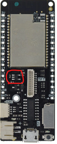

FredJr
Joined: Tue Aug 16, 2022 10:25 am
Re: ESP32 Wrover not booting
Postby FredJr » Tue Aug 16, 2022 10:37 am
Hi.
I have other problem.
I had working ESP32-WROVER with connected temperature sensor. Then I decide to connect another one sensor - DHT21.
And in one big mistake I connect + of sensor to GND on plate and GND of sensor to 3V3. When I see my mistake, I disconnect all sensors.
And now when I connect plate to USB - my computer doesn't see it on any port, and it's doesn't send any data to MQTT.
Is there is any way to fix it or it's complitly dead?
FredJr
Postby FredJr » Tue Aug 23, 2022 8:21 am
I think I burned this chip. It`s marked S2TI.
Can I replace it? What kind of chip is this?
Thanks
