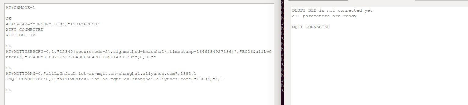

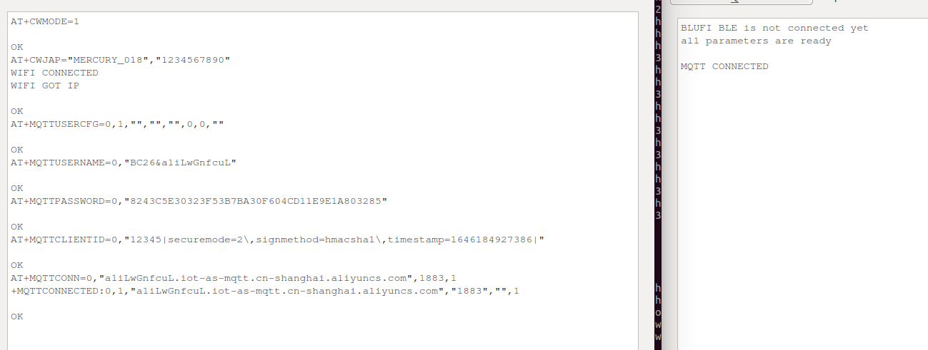

client id: 12345|securemode=2,signmethod=hmacsha1,timestamp=1646184927386|
password:8243C5E30323F53B7BA30F604CD11E9E1A803285
host:a1iLwGnfcuL.iot-as-mqtt.cn-shanghai.aliyuncs.com
端口:1883

我这边测试是成功的,我使用的固件是:release v2.3 ESP32C3 AT
AT+GMR
AT version:2.3.0.0(e98993f - ESP32C3 - Dec 23 2021 09:03:35)
SDK version:v4.3.1-354-g98d34e5
compile time(9ff1373):Dec 24 2021 11:22:05
Bin version:2.3.0(MINI-1)
OK

谢谢,我测试OK了,但我想问一下如何用at指令如何上传不同的数据,我不能每次都用这个指令吧:AT+MQTTPUB=0,"/a1iLwGnfcuL/BC26/user/light_control","hello dfejzdffafe",0,0

你好,我最近测试也遇到同样问题,结果换一个网络就好了
