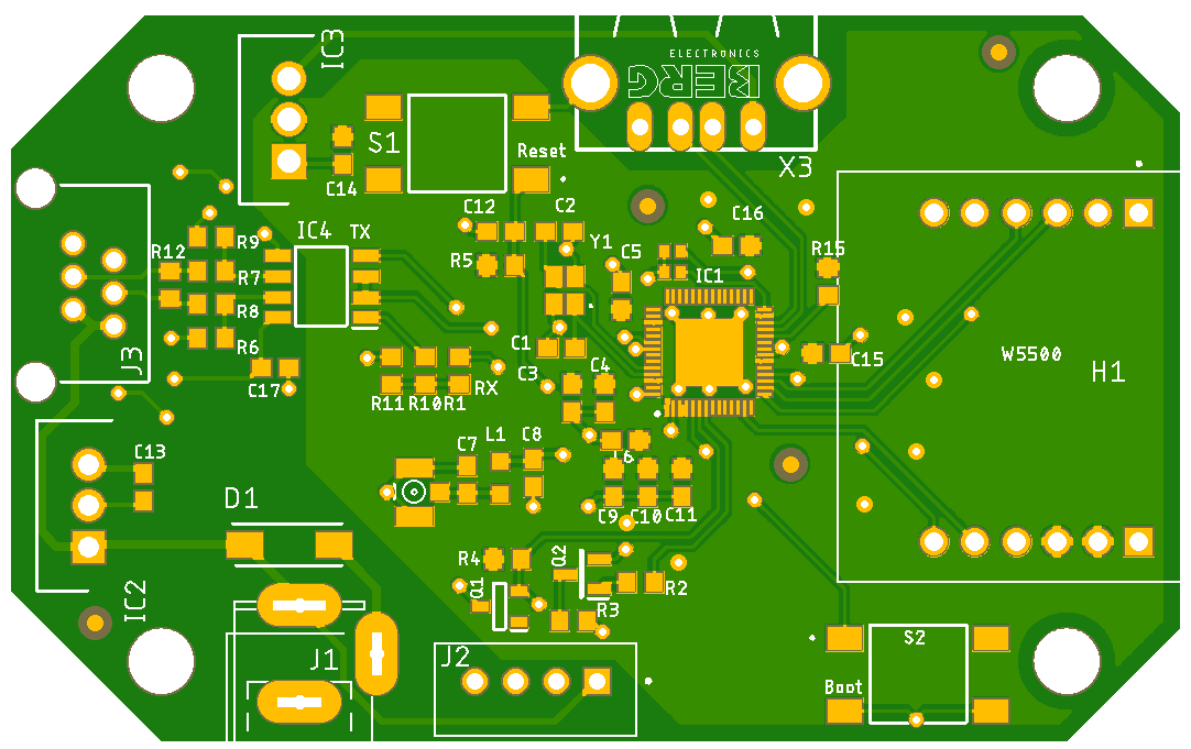

Yeah my pcb matches the schematic exactly and no shorts to be found on the boards.Honestly, I'm kinda scratching my head on that issue... from what you have told and shown here, it should work. Are you sure your PCB matches the schematic, as in, you don't have a short or anything that throws a wrench in the works? Can you try on another PCB?
I tried on a couple of pcb's and both go into a boot loop after flashing an program to th esp. Even a simple blink program or print to serial program gets them into the boot loop.
It looks like the esp never gets into the setup() function, since it does not print anything of the program to the serial console.
I just tried on a thirth pcb and it also resets the whole time.
I can only program the board via the uart tx and rx line which i also use for RS485, but the converter chip should not work since i don't switch the flow control pin.

This is my pcb, not sure it helps.
After i removed IC4 (the rs485 converter), all communication stopped. Tried to put an 10uF capacitor between gnd and EN, but nothing changed.

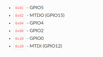

Ive been trying to reproduce boo mode and i have to admit i failed. I cant find combination of known bootstrap pins which is giving boot:0xa
I can reproduce this message when GPIO46 is high when trying to enter bootloader mode (IO0 + EN):
this one with GPIO45 high when normal reset:
normal bootloader mode(IO0 low, IO45 and IO46 also low):
and just normal boot:
Sadly S2 documentation is missing this section available for old esp32:
https://docs.espressif.com/projects/esp ... de-message

The ESP32-S2 does have some docs on the GPIO_STRAPPING in the TRM, but bit 1:0 are undefined there. From what I can find if I dig in the archives (it's been 3 years since we worked on that chips design), those bits *may* be defined by the state of U0TX and U0RX (GPIO1/2), but the doc I have isn't that clear on it. What I can tell you is that those bits shouldn't matter at all if you keep to the states in the datasheet: either with IO0=1 to boot into 'normal' mode or with IO0=0&IO46=0 to boot into download mode, the lower bits are ignored in ROM code. Given that, 0xA should give you a normal boot; I think the differences in boot mode between PCBs are a red herring.
Re the 32KHz crystal: it has use in deep sleep modes, but it's not necessary for basic operation of the chip at all.
Two more (somewhat related) things you can try. First of all, maybe there's some madness going on with the internal flash. If you can compile a project in ESP-IDF, can you try lowering the flash speed? Should be in menuconfig, under 'serial flasher config'. I think you have it set to 80MHz, you can try lowering it to see if that changes anything.
The other one is that you don't have any external capacitors on VDD_SPI. Looking at the datasheet of one of our modules that use the same chip, there's an 1uF plus a 0.1uF capacitor on the VDD_SPI pin. Perhaps adding those fixes your problem?
(Btw: you do know that there's no need to connect that RS485 chip specifically to U0RxD and U0TxD? All our ESP chips have multiple UARTS, and you can route those UARTS to any IO pin, and by using an uart different from UART0, you don't get the issue that the chip will try to emit boot messages there.)

I cannot hardset the state of IO46 due to how small the pin is, but if it is pulled down by default. Also i am able to put my diy board into download mode, so i think this pin is pulled down correctly.The ESP32-S2 does have some docs on the GPIO_STRAPPING in the TRM, but bit 1:0 are undefined there. From what I can find if I dig in the archives (it's been 3 years since we worked on that chips design), those bits *may* be defined by the state of U0TX and U0RX (GPIO1/2), but the doc I have isn't that clear on it. What I can tell you is that those bits shouldn't matter at all if you keep to the states in the datasheet: either with IO0=1 to boot into 'normal' mode or with IO0=0&IO46=0 to boot into download mode, the lower bits are ignored in ROM code. Given that, 0xA should give you a normal boot; I think the differences in boot mode between PCBs are a red herring.
Good to know that i didn't miss an crystal.Re the 32KHz crystal: it has use in deep sleep modes, but it's not necessary for basic operation of the chip at all.
I am using the arduino ide v2 where i program with the esptool v3.3. I tried setting the speed to 40MHz, but nothing different happend.Two more (somewhat related) things you can try. First of all, maybe there's some madness going on with the internal flash. If you can compile a project in ESP-IDF, can you try lowering the flash speed? Should be in menuconfig, under 'serial flasher config'. I think you have it set to 80MHz, you can try lowering it to see if that changes anything.
The vdd_spi pin capacitors would be a good last option, sadly i need this out tomorrow. I only have 2 diy boards with me and ruined both since the pins are so small.

We are thinking about switching to the module instead of the chip due to time and deadlines. This way we know for certain that all pins for the chip are connected and easier to solder to while trouble shooting with the bigger pads. The module we order to test out is the: ESP32-S2-WROVER.
Good suggestion, did not thought about the boot message on UART0. I will connect the RS485 chip to UART1 (IO 17 and 18). On the initial diy pcb i designed the board to be programmed via usb in boot download mode, but switched to serial when i could not connect to it via usb.(Btw: you do know that there's no need to connect that RS485 chip specifically to U0RxD and U0TxD? All our ESP chips have multiple UARTS, and you can route those UARTS to any IO pin, and by using an uart different from UART0, you don't get the issue that the chip will try to emit boot messages there.)
Re: ESP32 S2 FH4 First factory upload
That should work just fine; from what I recall that module only needs a proper power supply and the reset RC network to be usable over USB.Alternative route:
IO17/18 will work, but those are merely the default pins for that UART. On ESP32 chips, with the exception of some high-speed peripherals, thanks to the GPIO matrix you could have chosen any free IO pin to route the UART1 signals over. Just saying, as in my experience knowing that can make PCB design a lot easier!Good suggestion, did not thought about the boot message on UART0. I will connect the RS485 chip to UART1 (IO 17 and 18). On the initial diy pcb i designed the board to be programmed via usb in boot download mode, but switched to serial when i could not connect to it via usb.
