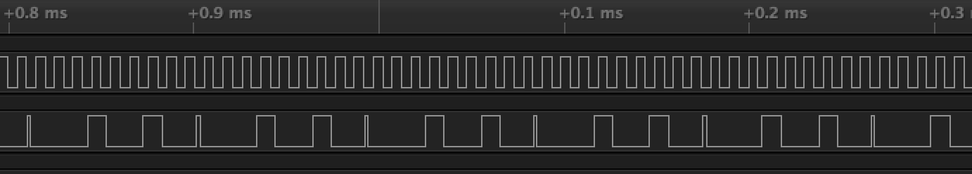

I'm working on a project using MCP23017's which are port expanders using the i2c protocol. Occasionally, the chips start returning the wrong readings. I use relays in my design, which I imagine is causing the problem. I hooked it up to a login analizer and got the following result.
Screen Shot 2017-06-16 at 2.35.03 PM.png (21.57 KiB) Viewed 21049 times
Right now, when I detect a problem, I reset the esp32 with esp_restart(). This always fixes the issue. Is there a way to correct this without a reset? Is there some way to reset the i2c bus?

Without more context, the I2C trace doesn't look "wrong".
What you seem to be showing is a clock rate at the top signal and a data trace at the bottom signal. It also looks like you are using the Saleae software for examining the trace. It has an I2C mode where you can ask it to decode the protocol into I2C values. Are these parsing correctly. My arithmetic may be off, but I think I'm seeing 8 clock pulses before repetition.

That top is the clock. It is unable to parse the signal. The small segment I showed in the first picture repeats continuously. When it works normally, I only see it poll the mcp's a few times a second.
ok
we see the clk
we see the data
we see no start condition
we see no stop condition
can you post please the CS ( /CE or RST ) pin too?
or how you interference you the device you want to poll?
thank you

Hi, im also trying to make mcp23017 to work and those are my findings. During reading there are clock speed drops about 33%. In my test case from 100kHz to about 65kHz and from 200kHz to about 129kHz.
I have to say i dont have any issues with mpu6050 on the same i2c line.
