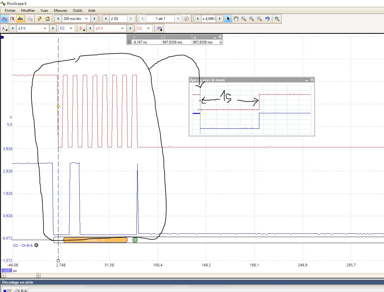

I have a the same problem and I think it's related to master write at first.
My signal shows that the master I2C doesn't transmit the 9th bit for slave ACK. My slave send an ACK but the master timout after the eighth bit. You can see on the attached image that my slave maintain ACK.
Then after 1 second wait the master send the databit.
My code was working at first EPS8266, now I'm on ESP32-WROOM-E (on ESP32-Ethernet Starter kit)
I updated today IDF from 4.2 to 4.4.2 last release, same problem.
I check with the documentation everything seems to be okay.
Same problem if I use ACK_IGNORE.
long timeout.JPG (154.41 KiB) Viewed 2640 times

Postby eliott » Mon Oct 17, 2022 9:35 pm
At my side the problem has been solved by enable interrupts: ESP_INTR_FLAG_INTRDISABLED is not OK
This works:
i2c_error=i2c_driver_install(I2C_NUM_0, I2C_MODE_MASTER,0,0,ESP_INTR_FLAG_LOWMED);
