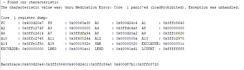

Hello All,
i'm a little clueless. I use a ESP32 with the Arduino IDE and the BLEDevice Lib.
From this lib I use the BLE Client Example. I have a BLE Device (LED Lamp) and want to turn it on and off.
With the NRF Connect App I figured out which Service and Characterisic is needed for this action.
If I try to use my ESP for this it does not do anything...more I get errors.
The thing that I don't get is, if I use another Service and Characteristic from the same Device from which I can read the Devicename, this works without a problem. I tested another different BLE Device and this I can also control with my code. Does anyone have a clue what I'm doing wrong or what I'm missing?

    Serial.println(" - Found our characteristic");
    // Read the value of the characteristic.
    if(pRemoteCharacteristic->canRead()) {
      std::string value;
      uint8_t* test = pRemoteCharacteristic->readRawData();
      Serial.print("The characteristic value was: ");
      //Serial.println(value.c_str());
      Serial.println(*test);
    if(pRemoteCharacteristic->canNotify())
      pRemoteCharacteristic->registerForNotify(notifyCallback);
    connected = true;

I hope someone can help.
Thanks in regard.
