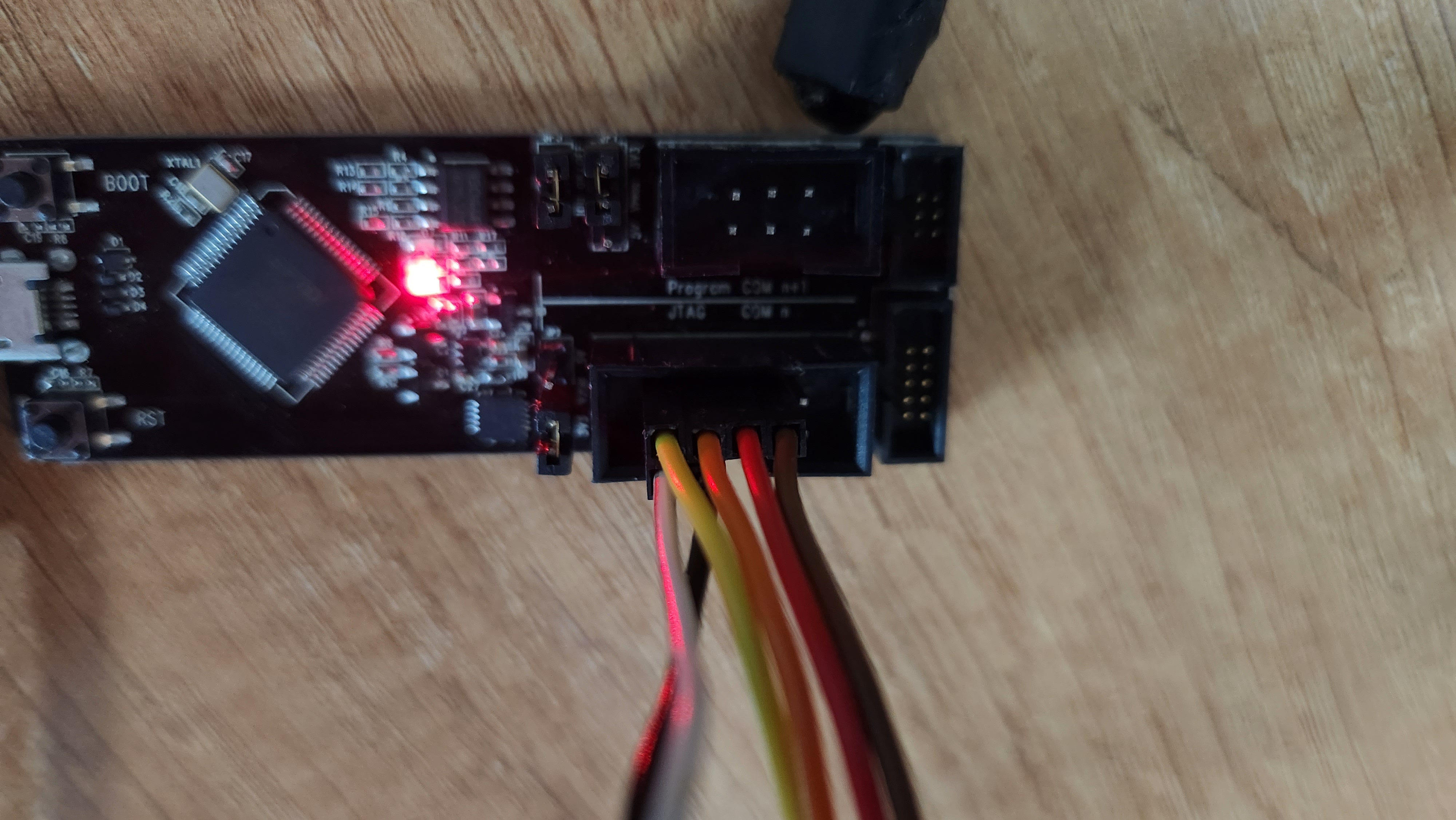

Every time I connect esp_prog jtag with esp32-s2-wrover based board esp32-s2-soala-1, I get the following error.

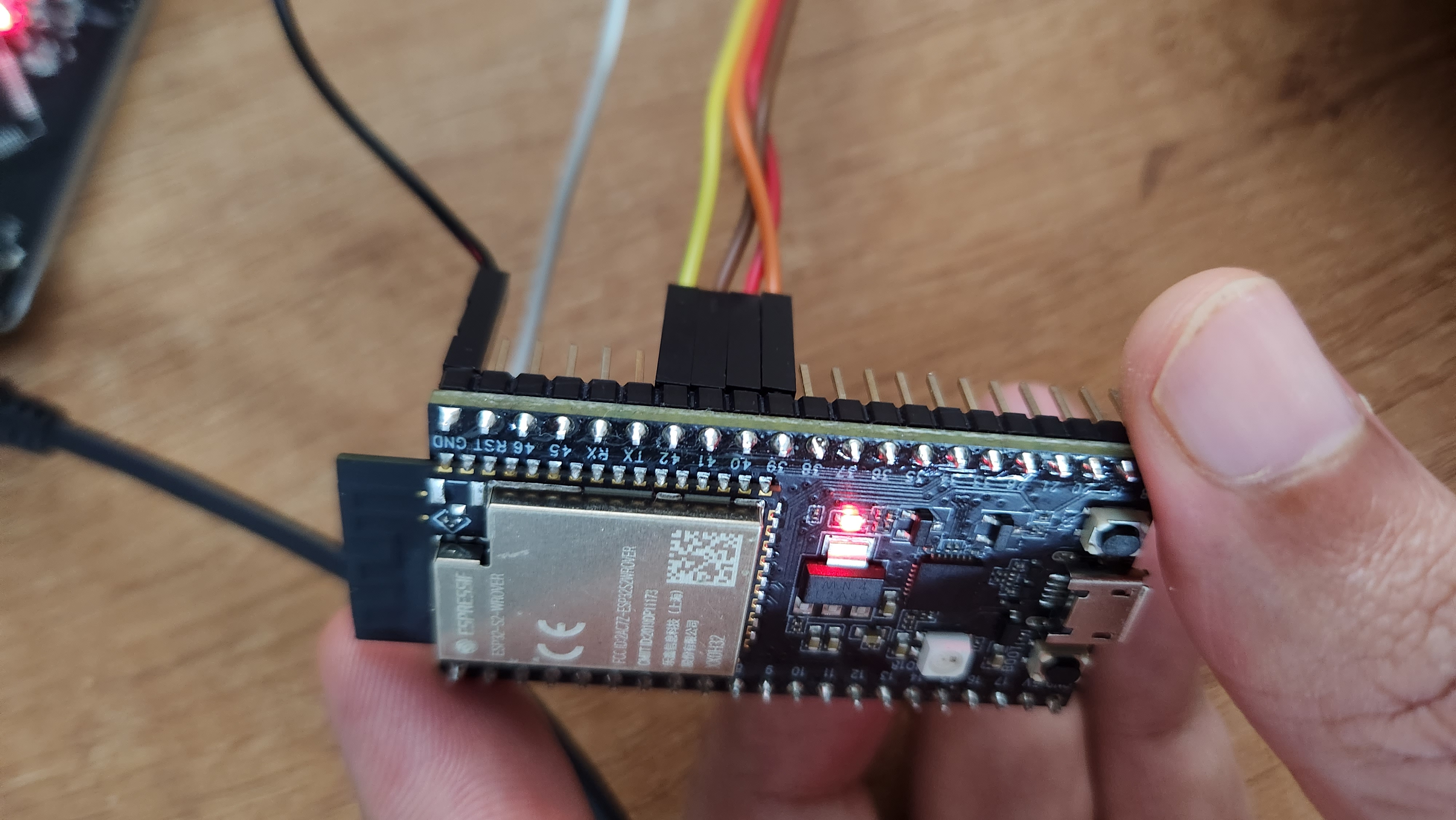

I searched forum and found that some pins connection is loose or missing. But I have checked connection multiple time. I always get the same error. Also tested if the connection is proper with multimeter.
My connection are
3.3V - 3.3V
GND - GND
ESP_TMS - GPIO42
ESP_TDI - GPIO41
ESP_TDO - GPIO40
ESP_TCK - GPIO39
esp32-s2 board is getting power and blink program is running. I am able to flash using usb serial.
But jtag esp_prog does not work.
I am attaching the images to show connections.
Is there any way to check if the esp_prog is faulty ?
Please help me to connect jtag with this board. I have spend a lot of time and could not find anything useful on google.

I tried with another board, got similar results.
Looks like there is some problem with esp prog.
I have ordered another esp prog. I would check with that and post results.

esp-prog was faulty, I tried with a new one and it worked.
