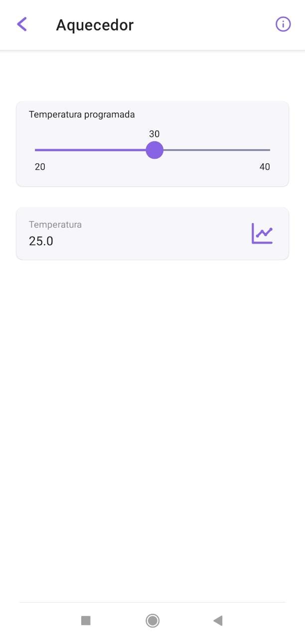

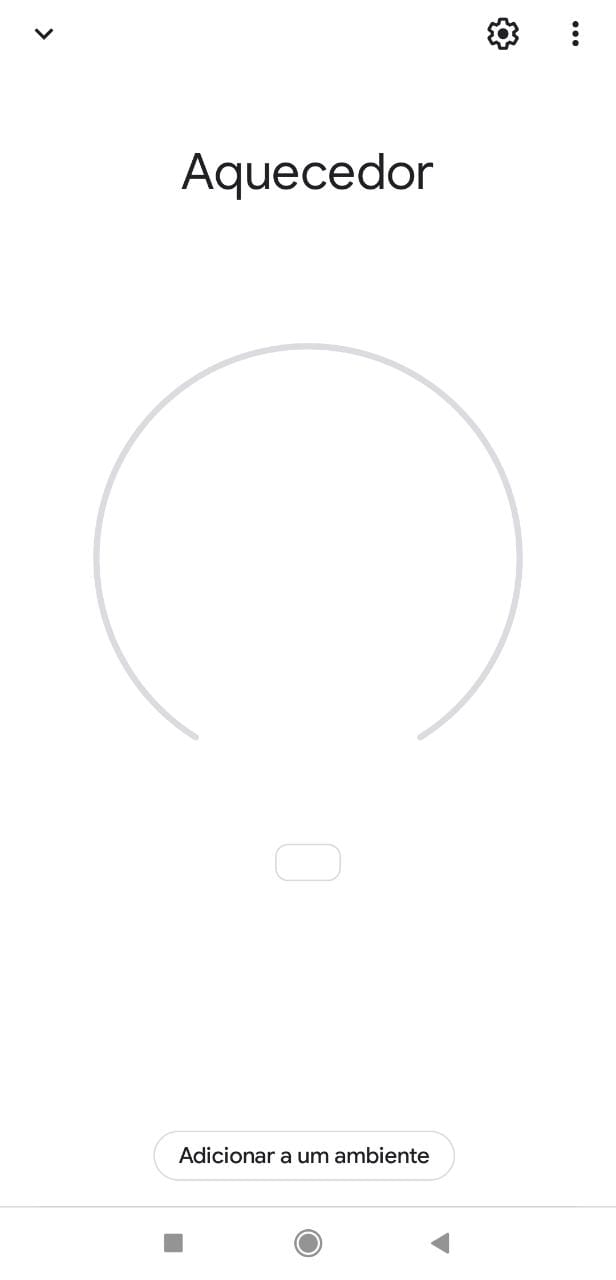

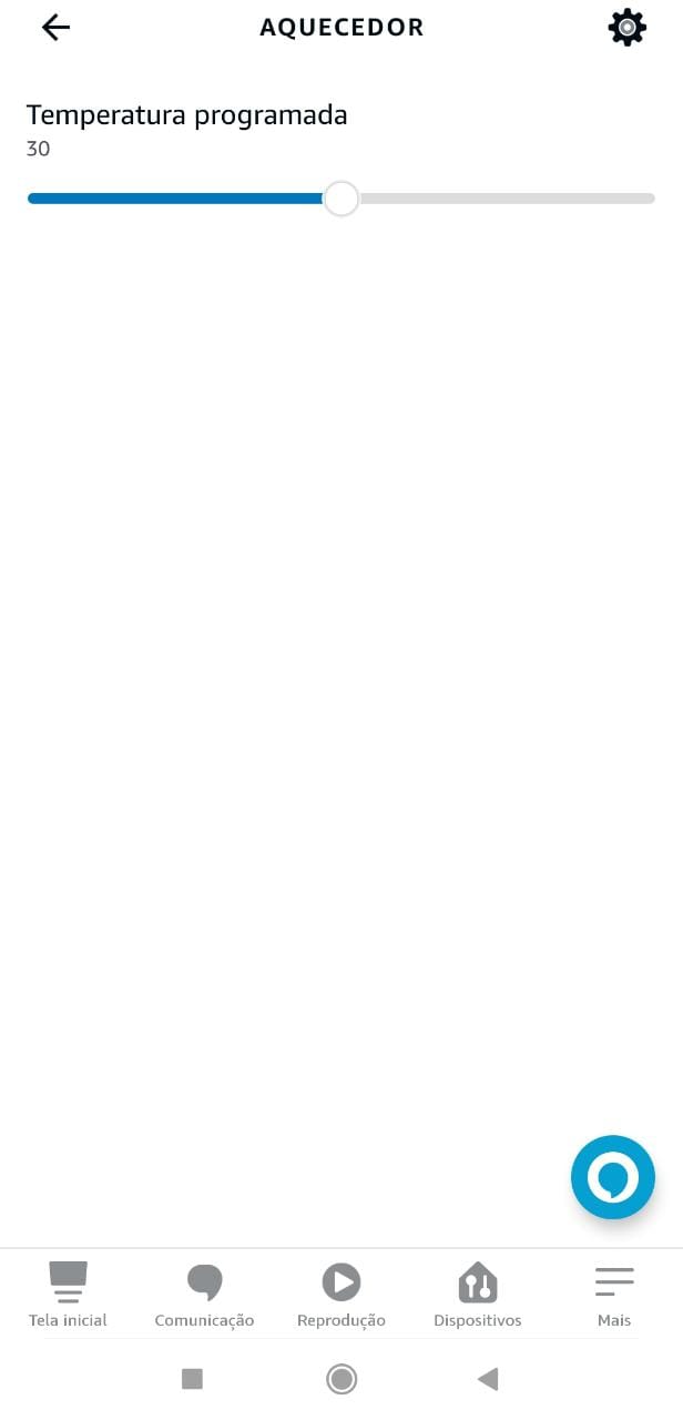

I created a thermostat type device in Rainmaker. It works fine on Rainmaker and Alexa, but it doesn't work properly on GVA. In GVA it is not possible to configure the temperature.
Can anyone who has had this problem help me?

- Alexa
- WhatsApp Image 2022-12-14 at 17.31.45.jpeg (19.65 KiB) Viewed 4698 times
- GVA
- WhatsApp Image 2022-12-14 at 17.32.06.jpeg (17.63 KiB) Viewed 4698 times
- RainMaker
- WhatsApp Image 2022-12-14 at 17.32.22.jpeg (17.5 KiB) Viewed 4698 times

Can you share a snippet of your code (where you create the device and parameters) here so I can try it on my device?

This is the part of my code where I add the device:
Node my_node;
static int gpio_switch = 7;
Device termostato("Controlador de Spa", "esp.device.thermostat", &gpio_switch);
Param parametro_set_temperatura("Temperatura programada", ESP_RMAKER_PARAM_RANGE, value(20), PROP_FLAG_READ | PROP_FLAG_WRITE);
parametro_set_temperatura.addUIType(ESP_RMAKER_UI_SLIDER);
parametro_set_temperatura.addBounds(value(20), value(40), value(1));
Param parametro_temperatura("Temperatura", ESP_RMAKER_PARAM_TEMPERATURE, value(0), PROP_FLAG_READ | PROP_FLAG_WRITE);
my_node = RMaker.initNode("Spa");
termostato.addCb(callback_funcoes);
termostato.addParam(parametro_set_temperatura);
termostato.addParam(parametro_temperatura);
my_node.addDevice(termostato);
RMaker.enableOTA(OTA_USING_PARAMS);
RMaker.enableTZService();
RMaker.enableSchedule();
RMaker.enableScenes();
RMaker.start();
WiFi.onEvent(sysProvEvent);
WiFiProv.beginProvision(WIFI_PROV_SCHEME_BLE, WIFI_PROV_SCHEME_HANDLER_FREE_BTDM, WIFI_PROV_SECURITY_1, pop, service_name);

The list of standard devices supported by GVA and Alexa has been updated. https://rainmaker.espressif.com/docs/st ... ml#devices.Here, you can find the additional parameters that need to be added to your code.
Definitions of these parameters can be found here https://rainmaker.espressif.com/docs/st ... parameters
Can you make appropriate changes and try again? If the issue still persists, please upload the complete sketch after changes.
