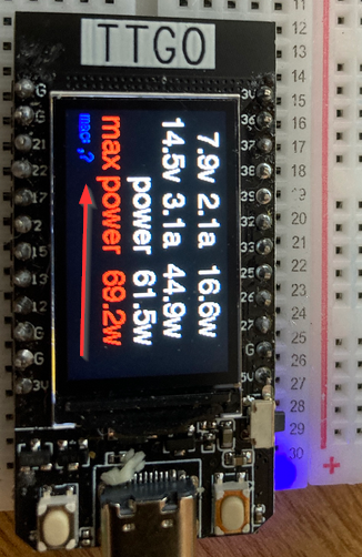

I'm trying to display the mac address on the display... Ive had no trouble displaying anything else but it displays
mac: ?
I use the same String variable and output to the serial console with no issue
here is what displays in serial console
IP Address: 192.168.1.162
signal strength (RSSI):-53 dBm
To see this page in action, open a browser to http://192.168.1.162
mac:3C:61:05:0C:F3:44
and again ...what is displayed in the TTGO display for the mac line is
mac: ?
Note that I was able to display the IP where the mac was with no issue

  //sprintf(line5, "IP:%s  mac:%s", IPString, wifiMacString);
  sprintf(line5, "mac: %s", wifiMacString);

tjodork
Joined: Thu Dec 15, 2022 4:17 pm
Re: TTGO cant get mac address to display
Postby tjodork » Fri Dec 16, 2022 5:02 pm
turns out I cannot pass String into sprintf
so I had to add .c_str() to each String
sprintf(line5, "%s %s", IPString.c_str(), wifiMacString.c_str());
whats puzzling is why the compile wouldn't complain about that
