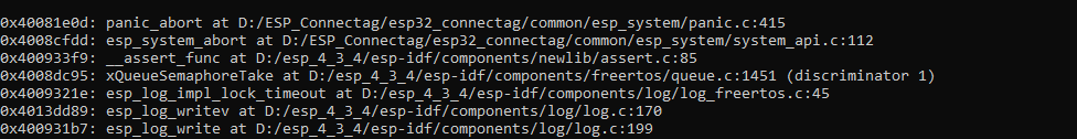

Hello I'm working with ESP 4.3.4 and sometimes my application crash inside a ESP_LOGx function, the points where the crash happens is always the same. What I mean is that there's other points inside the firmware where I call a ESP_LOGx and the firmware dont crash.
Below is an image where the crash happens.
Captura de Tela (102).png (20.2 KiB) Viewed 2199 times

Running in ISR function?

Postby BrunoOtavio » Mon Jan 09, 2023 7:47 pm
It's a normal task.

Postby mbratch » Tue Jan 10, 2023 12:35 am
Depending upon how deeply nested your function calls are or how much data you have on the stack, it still could be a stack allocation issue for your task. You could try increasing the stack allocation.
