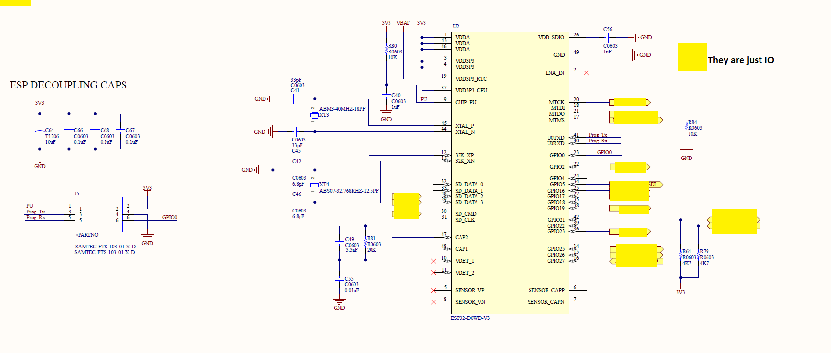

Hi all,
ESP32 was used without flash and ram because there was no space left on the PCB. Only ESP32 chip is used.
A design was obtained by examining the datasheet and the reference manual.
PCB Design:
However, a problem was encountered during flash.
Problem:

A fatal error occurred: Packet content transfer stopped (received 8 bytes)
CMake Error at run_serial_tool.cmake:56 (message):
  /Users/inthecahc/.espressif/python_env/idf4.4_py3.9_env/bin/python
  /Users/inthecahc/esp/esp-idf/components/esptool_py/esptool/esptool.py
  --chip esp32 failed
FAILED: CMakeFiles/flash /Users/inthecahc/INTHECA/Workspace/esp32/build/CMakeFiles/flash
cd /Users/inthecahc/esp/esp-idf/components/esptool_py && /usr/local/Cellar/cmake/3.22.1/bin/cmake -D IDF_PATH="/Users/inthecahc/esp/esp-idf" -D SERIAL_TOOL="/Users/inthecahc/.espressif/python_env/idf4.4_py3.9_env/bin/python /Users/inthecahc/esp/esp-idf/components/esptool_py/esptool/esptool.py --chip esp32" -D SERIAL_TOOL_ARGS="--before=default_reset --after=hard_reset write_flash @flash_args" -D WORKING_DIRECTORY="/Users/inthecahc/INTHECA/Workspace/esp32/build" -P /Users/inthecahc/esp/esp-idf/components/esptool_py/run_serial_tool.cmake
ninja failed with exit code 1
Could not find the source of the problem.
Can ESP32 be used without flash and ram?
Is there something wrong with the schematic if it can be used?
Asking for help on the subject.

The ESP32-D0WD cannot be used without flash memory. The ESP32-U4WDH or ESP32-PICO has the flash memory embedded in the SoC.
