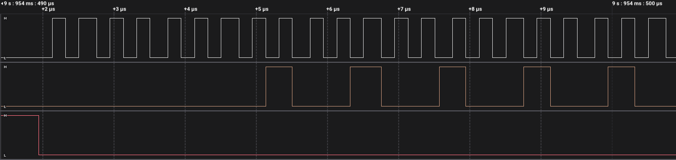

But as soon as I start sending data (1 UDP packet of 4096 bytes every 8 ms, fragmented on the IP level) to the ESP32 over UDP to a random port over Ethernet, even if there are no sockets listening in the firmware, some SPI transactions start acting weird. I want to transmit the bit pattern 100 in a repeated way. Here's what a normal transaction looks like. Signal above is MOSI, below is SCK.

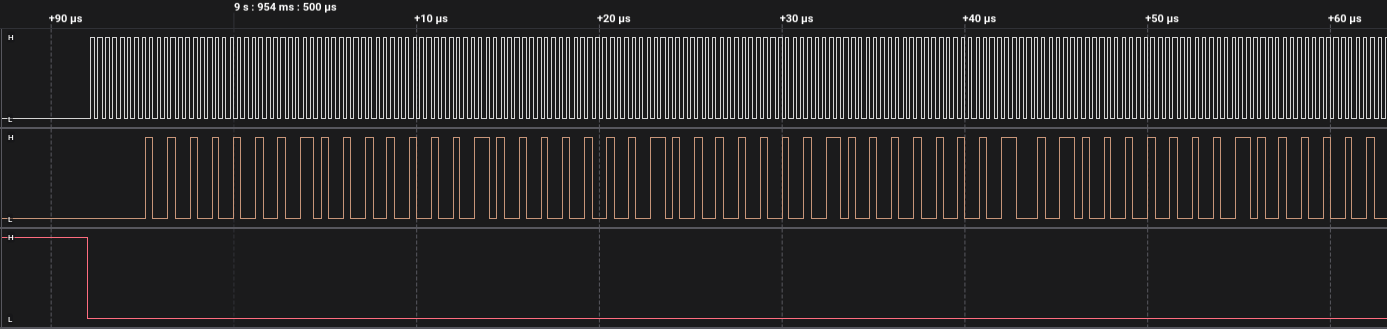

But a few times every minute at irregular intervals this is what I get:
It looks like MOSI is delayed for some reason. The buffer containing the data that is transmitted over SPI is not modified in the meantime.
Any ideas why this is happening? If I stop sending the data over Ethernet, all transactions become normal again without exception.

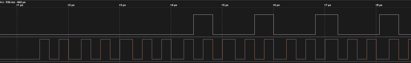

Could you also output the CS signal? I want to know whether the MOSI starts late specifically because SPI has started transmission or just because SPI starts late

Hi, thank you for your answer.
Here's a capture with the CS signal included:
There are 2 more strange things I discovered.

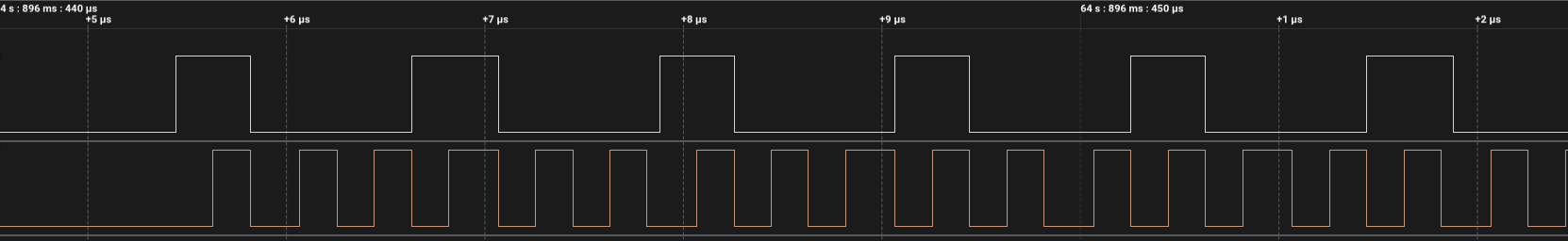

I changed the pattern to [0b10010010, 0b01001001, 0b00100110] (so it's the bit pattern 100 repeated over 3 bytes with the exception of the last repetition which is 110). The buffer is prefilled this this pattern at initialization and not changed in any way later. This way the MOSI signal should be 7 short pulses followed by 1 long pulse. Now, if you look further into the transaction, this is what you see:
Looking closer at the +40 us line:
In the beginning the signal looks OK but then you see 1 short pulse followed by a long pulse, and then again 7 short pulses and a long pulse again. This 1 short and one long pulse is not what it should be according to the original pattern. Also note the irregular period of MOSI: the period of the last long pulse before the error is 1.188 us which is normal, but the one after (the one before the single short pulse) is 2 us. The forum won't let me upload more screenshots so I put it here: https://www.imgpaste.net/image/K6IJ9U
If you look at the next transaction, it's normal again which confirms that the pattern has not changed in memory.

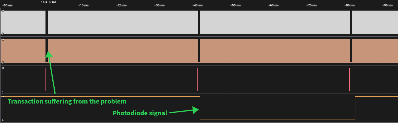

Here's a bit of help to catch the problem. The bit pattern is crafted so that when MOSI is wired to an addressable LED strip (WS2812B and friends) it should cause all LEDs to emit a dim light (red, green and blue all set to 1 which is the minimum brightness). When the error happens, all LEDs blink one time. This is because the bit stream that they synchronize to in the beginning is suddenly shifted after a few bytes so all values become something else (2^n where n is random according to how many bits the SPI peripheral skipped in the beginning), but then the next transaction is very likely to be normal again, so they all go back to 1.
Now you can catch the blink with a photodiode and use its signal as trigger for a logic analyzer. The wrong transaction is the one before the photodiode triggers.

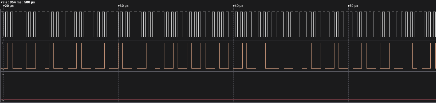

One more strange thing can be seen at the end of the SPI transaction showing the problem. According to the bit pattern in memory MOSI should end in 7 short pulses followed by 1 long pulse. But this is what happens:
