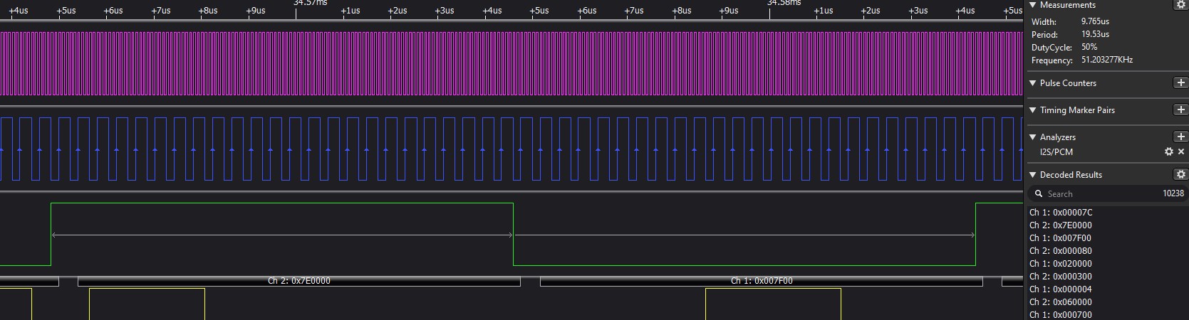

I'm having difficulty getting LRCLK and BCLK correct with 24-bit I2S.
With 48k sample rate I'm getting the correct MCLK (12.288) however LRCLK is around 51 kHz, BCLK is correctly aligned to LRCLK.
At 44.1KHz same issue with LRCLK close to 47kHz.
The issue occurs on both an S3 and a traditional ESP32 DevkitC.
Is there something I'm not setting correctly?
ESP32 I2S 24 bit issue.jpg (161.38 KiB) Viewed 1252 times
