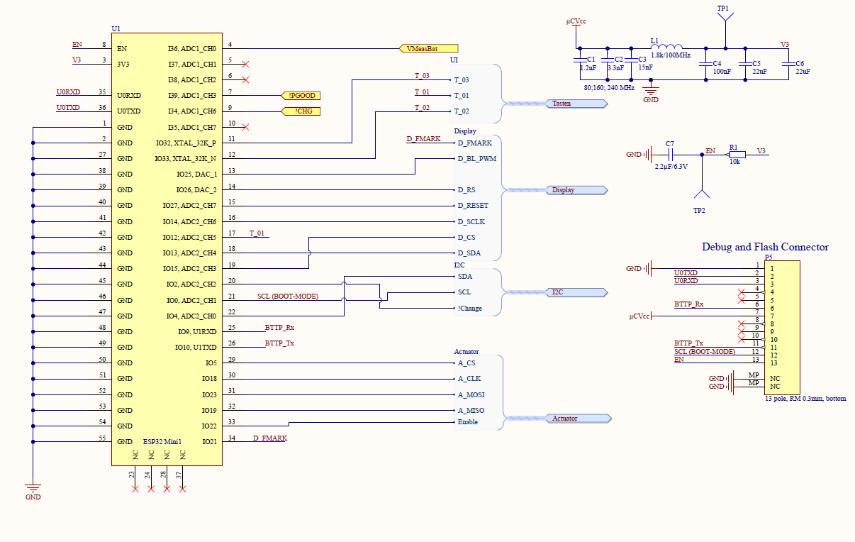

I try to programm an ESP32-MINI-1 module via UART by using ESP-PROG. Unfortunately I cannot establish communication with the module via UART0. But I get in a programming attempt via UART1 to change the baud rate:

Enable and boot pins are set correctly. I have tried different baud rates without success. RX and TX interchanging is already excluded. Does anyone have any idea why the module can't be programmed and why it talks on the wrong UART in boot mode?

So you could not see any log through UART0? Could you measure any signal at UART0 via oscilloscope? How many boards do you test? The power supply is provided by ESP-PROG? If 3.3 V is stable?

I cannot see any log through UART0.
I can measure the incoming signal with oscilloscope and it does not show any abnormalities. But it is no response from ESP32.
Modules are integrated in a circuit board with some peripherals (see attached image). Three boards are tested so far.
