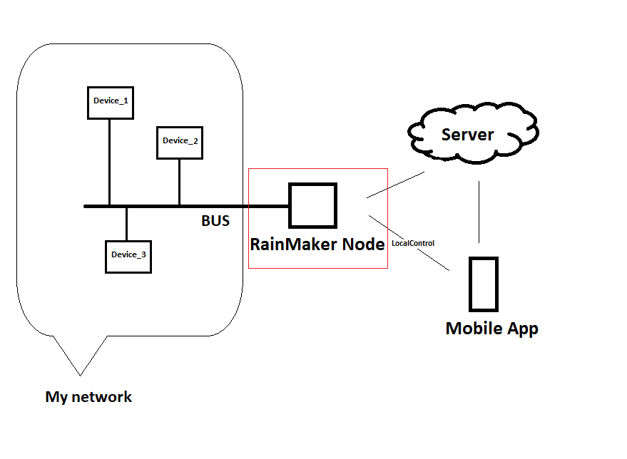

Postby Stipa88 » Sat Jan 28, 2023 6:22 pm
Hi
This is my situation.Image
I would like to group the devices as follows:
- only the ESP Node is visible in the application (it acts as a "group" that contains my devices)
- The ESP node "contains" my devices
I can't do that right now
That's why I need my own implementation, especially for Flashing "my devices" via MQTT messages.

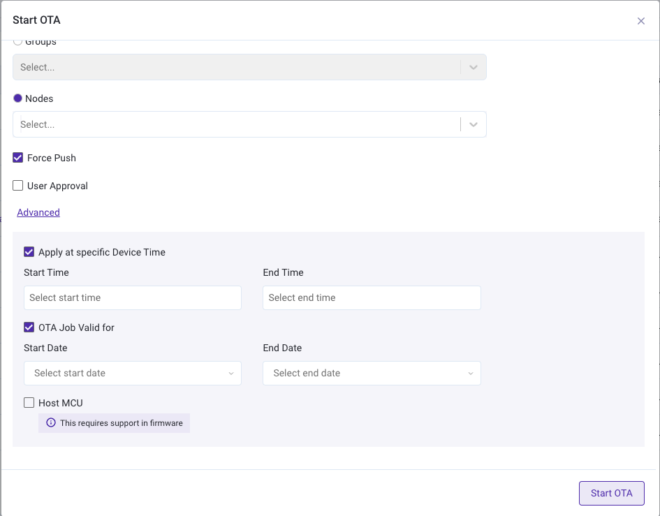

Postby Piyush » Wed Feb 01, 2023 5:23 pm
Multiple devices can indeed be supported with existing RainMaker as you can see in this example.
Moreover, while creating OTA Jobs via dashboard, you can provide some additional metadata via the "Advanced" section to give more info to the esp32 about what is to be done with the image.
Screenshot 2023-02-01 at 10.49.02 PM.png (53.81 KiB) Viewed 5401 times
If you use the underlying API, you can even add your own. custom data to tell esp32 to upgrade the other devices.
