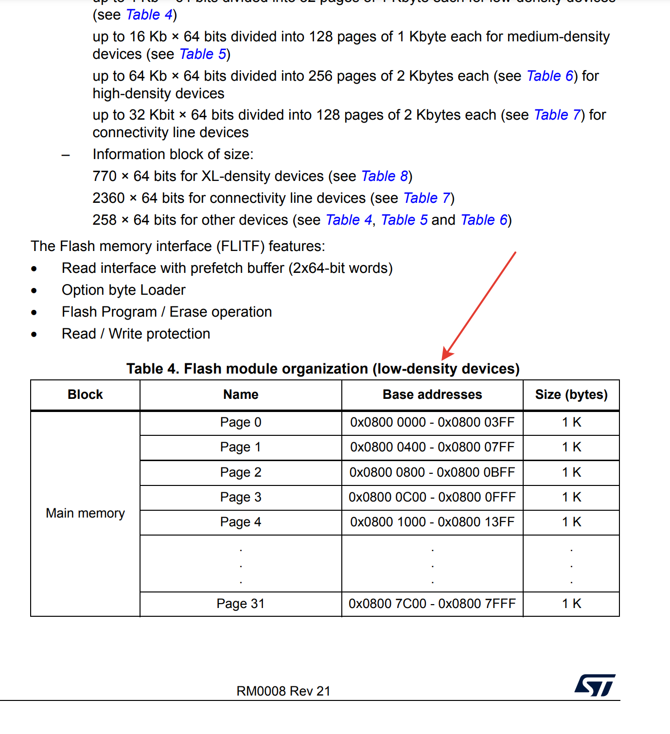

sorry for my English. there is a piece of code that works for me to write directly to the stm32 flash. I need to transfer to esp32 without changing the addressing. How to do it. I can't solve it for the second week.

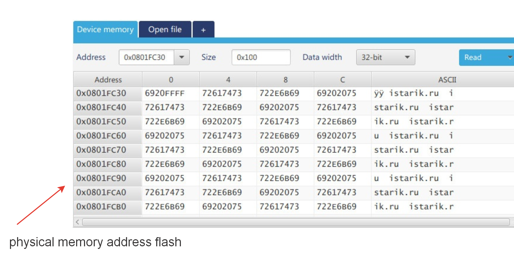

I have an esp32-s3 with built-in memory. In stm32f103, it is written to memory at physical addresses. then it is read from there into a program that accesses a specific memory address. how to do this in esp ?

Postby Sprite » Wed Jan 25, 2023 2:01 am
Do you mean that your variables point directly to the flash that you're writing? Esp-idf does not support that, because of a variety of reasons. You can write your values to flash and read them back into RAM when needed either using 'raw' SPI flash or partition access, or preferably using NVS. NVS has some advantages to the STM32 method: it's atomic (so there's no chance of corruption because of power loss or a crash; the NVS will always be in a consistent state) and it does wear leveling so you don't need to worry about the longevity of your flash.

If you are simply looking for something to make it easy to port your code, the EEPROM library uses location based addressing (https://github.com/espressif/arduino-es ... ies/EEPROM). It is built on top of the NVS storage system, so it can store ~15K without any modification. If you need more than that, you can do some custom partitioning to give yourself a larger nvs partition. It is not going to be quite as performant as directly writing to the flash, but most of the time the flash is much slower than your code anyhow.
