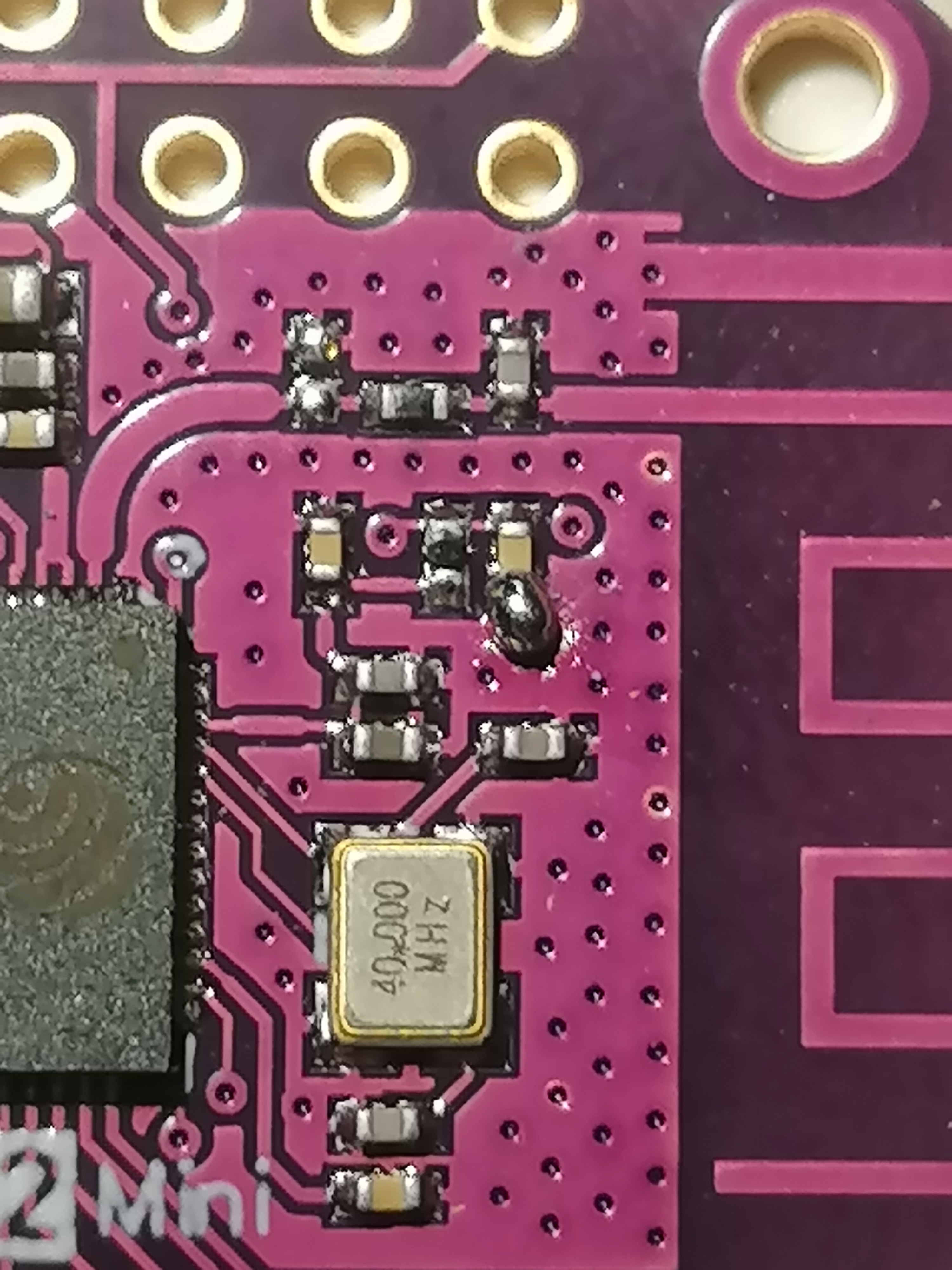

I confirm that some S2 Mini clone boards have a routing problem on the C14 ground pad.
After several hours of investigation (and one jeopardized board) the fix is straightforward.
Scratch the ground plane a put a blob between the C14 cap and the ground plane. See attachment.
The WiFi is now rock solid and stable, this make a huge difference.
Cheers.

Re: ESP32-S2 reboots when WiFi is used
Nice! Thanks for the pic and confirming this was the issue and the workaround works.

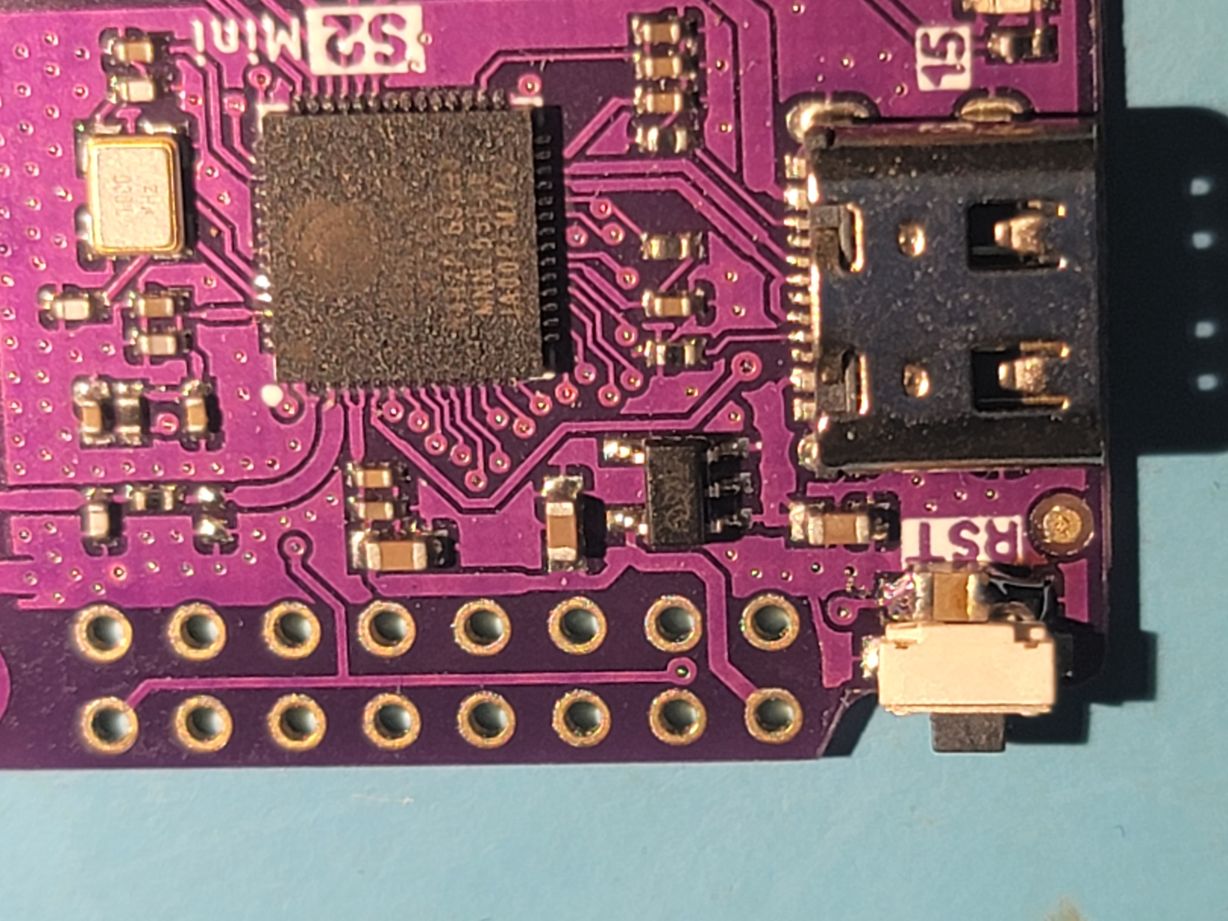

Verified the EN line is very noisy on bad esp32s2 mini boards and just holding the corner of the board by the EN pin smooths out the EN signal. I added a larger cap to between EN and ground and it seems to have cleaned the signal up and no more reboots. 5/7 of my esp32s2 minis has this same problem causing resets whenever my code tried to start the wifi connection.
beachmiles
- Posts: 4
- Joined: Wed Nov 30, 2022 9:13 am
So the EN line is routed all the way down to the reset switch and it seems like somewhere along that trace it is picking up noise. Adding a small 22uF 6.3V cap along the edge of the reset switch is an easier place to tack on a cap as one side is ground and the other is the EN line. There is already a large 44uF cap on the other side of the board that ties EN to ground as as been described in this thread but that part doesn't seem to be enough and scratching that edge to get a better ground connection didn't seem to help with my resets as it already had a good ground connection there at the top of the chip.
The 805 size cap I used, needed a pretty large soldier bridge but not too hard. I didn't have any bigger ones on hand which would have made it easier.
I'm guessing this is partially why these esp32s2 mini boards are so cheap. Only 2/7 working boards is pretty terrible, hoping this fix is all that's needed to make these things usable.

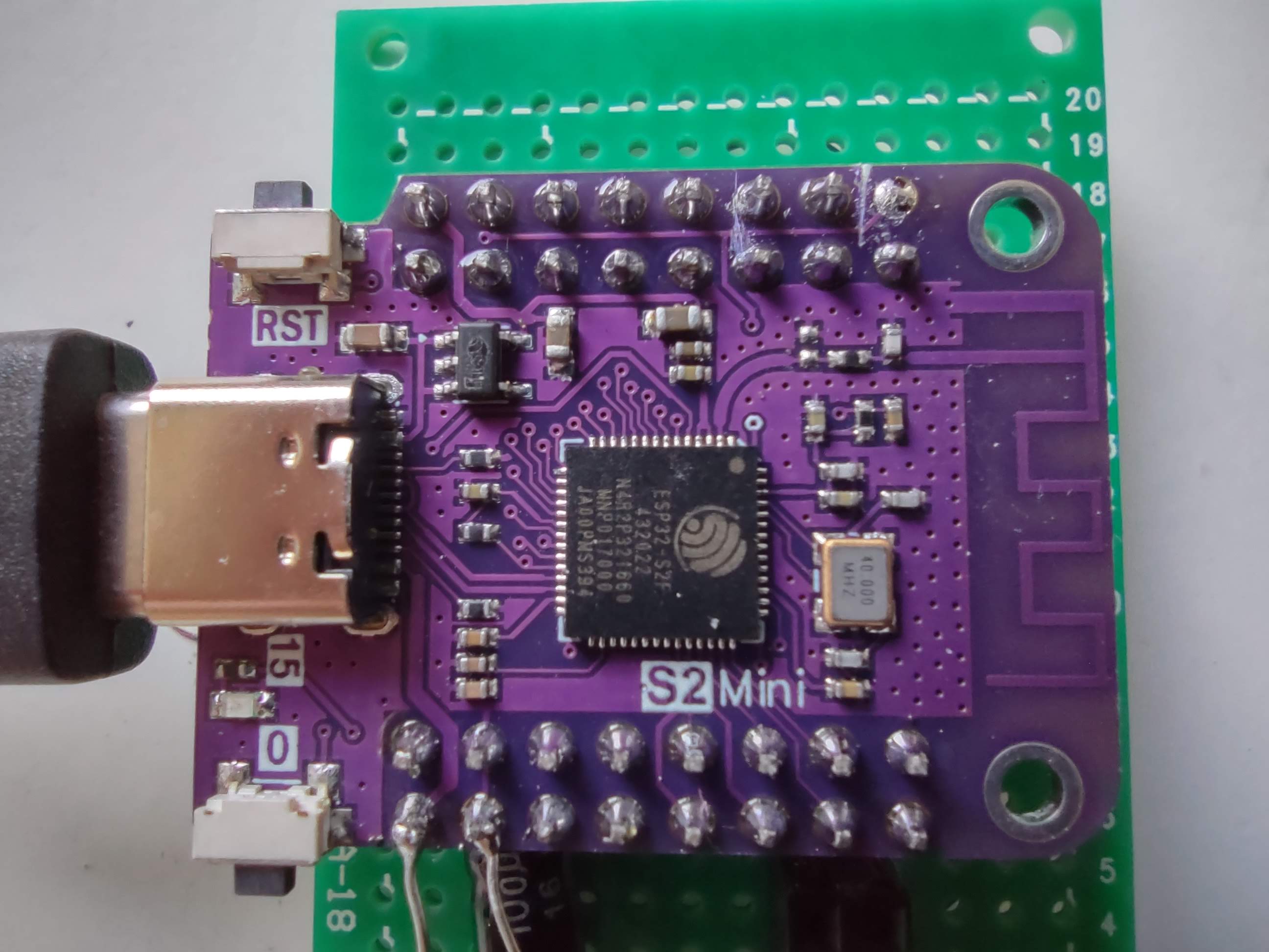

I have the same problem, 1 of 3 is working correctly and 2 works but when I use the wifi then they will sometimes reboot or just stop.
I remove the EN pin and shortened the track ( so that it will not pick up noise from the RF antenna ),Did not help,
I even connected the EN to 3v3 also did not help.
The same code I have run on an ESP32C3 and ESP32S no problems.

beachmiles
- Posts: 4
Im not sure you are supposed to pull EN directly to 3.3V as it may screw up the esp32 init. Try putting a large cap between the EN and GND like I did in my picture above.I have the same problem, 1 of 3 is working correctly and 2 works but when I use the wifi then they will sometimes reboot or just stop.

Many thanks to your proposed solution, it works for me too.Hi,
Cheers.
