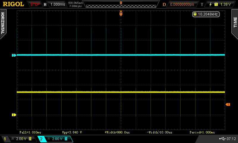

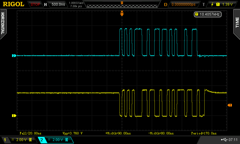

When the cable is connected and no flash operation is in progress, here are the waveforms on D+ (yellow) and D- (blue) lines:
These waveforms are the same in user app mode and in boot mode. As you can see, USB packets are sent every 1 ms.
When 'flash' command is issued, the data is sent on a high frequency, and difference between user and boot mode is that in boot mode the process actually moves on forward and eventually ends, while in user mode it seems stuck, probably meaning that there's no answer for a command (no answer, because program on pc thinks that after reboot device is in boot mode, but in reality it is in the user app).

Yes, those 1ms packets are SOF packets; they're 'background chatter' of USB. I'm afraid that with only a scope (no USB protocol analyzer) you're not gonna get far debugging this.
What I think is happening is that somehow, esptool fails to detect that this is an USB-serial-JTAG port and doesn't apply the correct reset sequence. I'll check with my colleagues if there's some way to force this.
