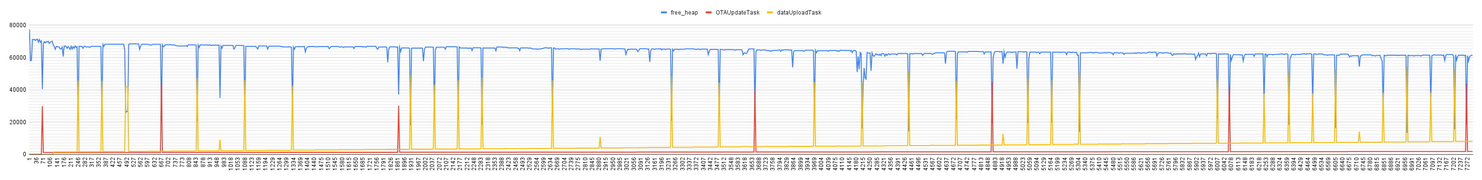

I am running tow tasks. One to send data to cloud platform using https request and 2nd to perform the OTA update. I run some memory analysis and got the results shown in the attached picture. The issues I am facing are:
1. The https requests are taking more than 40kb of memory when either uploading data or checking OTA update.
2. My device halts for 2-3 hours every 12 hours. It means device does not generate any logs and do not perform ota update and it restarts after two hours. When I look at last log, the heap memory shown is around 54Kb everytime when device halts.
3. My device crashes if both the tasks are trying to perform https simultaneously as I am running each task on each core of esp32.
I need help to reduce the memory utilization during https request.
Heap Memory Usage.png (142.18 KiB) Viewed 1479 times
